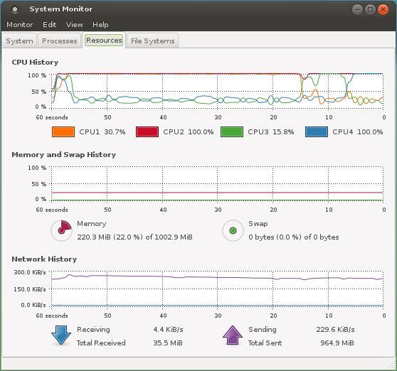

The webpage wont load for me i got it once but it wont load any more and 2 of my cores are running at 100% usage
and chrome keeps saying page is not responding

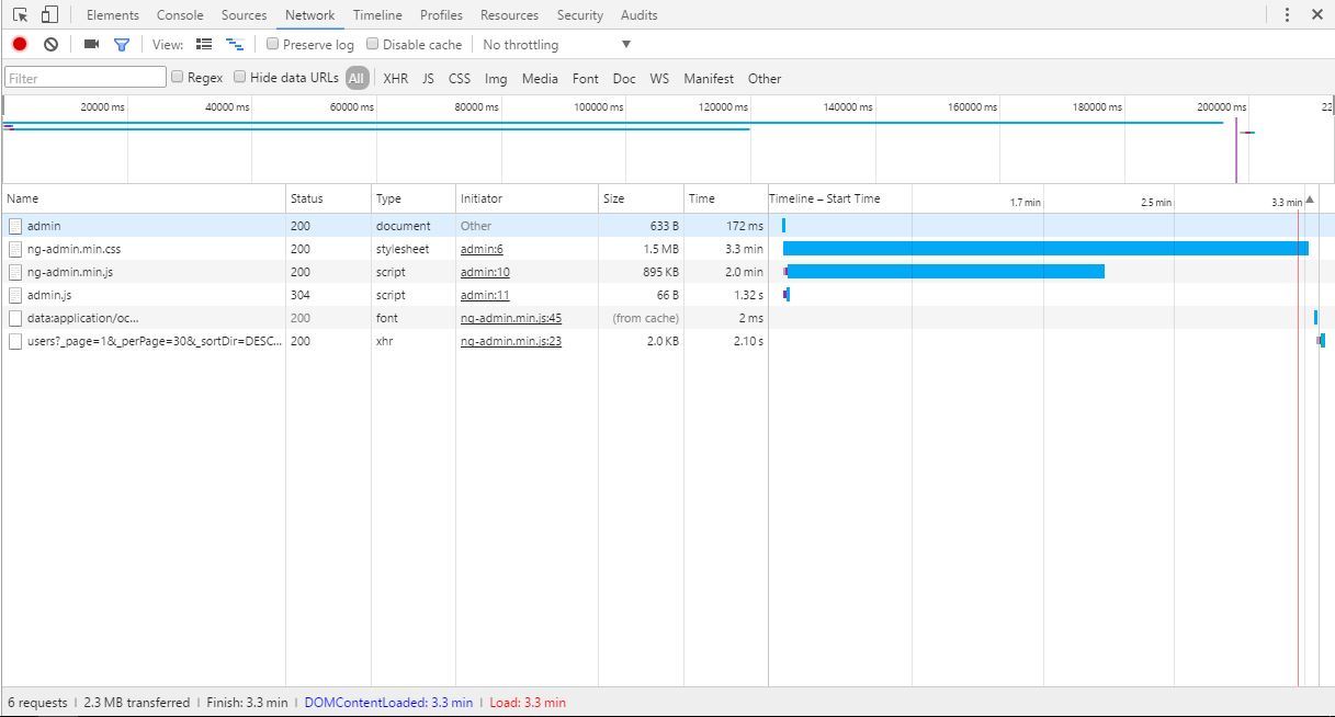

Could you please show browser ā€œDeveloper View -> Networkā€?
ok this is what i get
@FunguyPro maybe your PI is busy with something? From what I see all time is spend on js and cs files fetching.
Ok, i plan to upgrade to something more powerful soon
You don’t need. Blynk Server could be run on much slower hardware. Here is something specific with your board. Please double check nothing else is eating your CPU/DISK/NETWORK
It just runs high when Java is running once the server/webpage is launched it runs fine
This could happen in case you don’t have enough free memory.
It has 1gb and it never uses over 25%, i might check how much is GPU reserved
