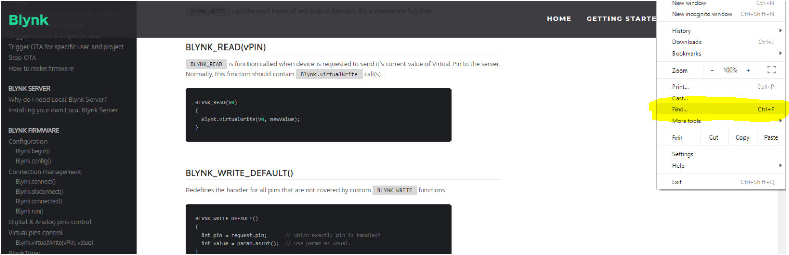

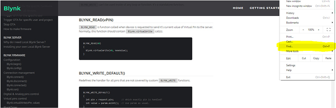

As it is a single long web page, search is a function of the browser itself
