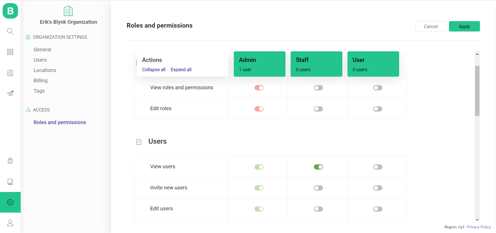

I am also not able to turn on the “suspend account” feature on any of my organizations. I see the feature listed, but when I try to edit the roles and permissions this feature is light grey, and will not allow me to select it. In fact, I cannot edit any of the roles and permissions for admin. I can edit the roles and permissions (including the suspend account feature) for the staff and users.

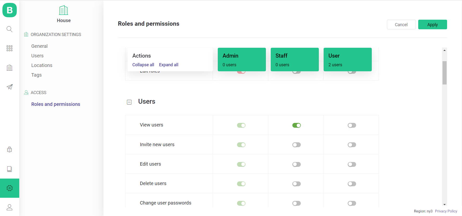

In sub organization (called House) , User 1 (main account) is not listed as the admin in the sub organization. If I switch to the sub organization (Search, my organizations, switch to), go to settings (gear icon), and then to roles and permissions; there is 0 users for admin, and 2 user for user (my test account, and my wife). Also, as user 1, when I click edit (under roles and permission) I cannot edit any of the admin settings in any of the organizations (sub or otherwise), all of the tabs or of a lighter color and will not allow me to change them.

Well, your primary user isn’t a member of the sub organisation, but has admin rights because they are an admin for the top level organisation . Also, you’ve not given users permission to view users.
If you mean that you can’t edit the permissions for the Admin role that are “greyed-out” then this is normal.
correct. They do not need to see other users.
I cannot edit ANY of the settings under admin. As seen in my picture above all of the colors are lighter, and not accessible. I want to add the suspend user feature to the admin (for both organizations).

Sorry for the confusion. Screenshots are taken while logged in on main account (user 1 in your example).
I was concerned that the dashboard shows a 0 for ADMIN, as I was under the impression that as the creator of the sub-organization I (user 1) was the admin. It does show a 1 for admin under the main organization.
My main issue though is that I am unable to edit any of the permissions for admin (when logged in as user 1, main account), for any of my organizations (main and sub). This could be an issue caused by being logged into main account on 2 devices (laptop, and home PC). As I will not be home until later today, I cannot check if this is the cause of my inability to change the permissions.

This is newly added permission. All newly added permissions are disabled by default. Only superadmin (me) can enable this permission. And I just enabled it, so you can test it now.
The reason why you can’t edit the Admin role permissions is that some of the permissions open features we don’t want yet to be delivered to the end-users (like analytics, static tokens), etc. All these features are under development and testing.
On later stages, you’re as an admin will be able to edit sub org admin permissions. Or maybe we’ll need to introduce separate role like the owner. We’ll see.
