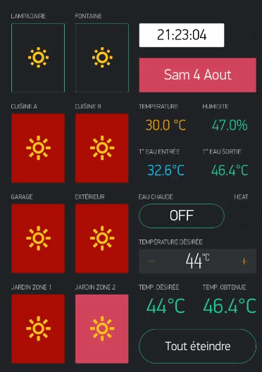

hi every body,
I need help with my project
I would like to turn off the lights that are on with one button.
but that disconnect blynk at the 3nd RF transmission
I tried lambda fonction, but It’s worse!
BTN value is button state
BLYNK_WRITE(V10)// ALL OFF

I’d try with timer. within BLYNK_WRITE(V10) just initialise timer with setTimer(interval, timer_callback, n-times)

My idea for your problem is setting up the timer for n- runs,where for each run it would check and eventually change the state of output (light). the setTimer() would be preset after calling the BLYNK_WRITE(V10)

this is the solution to RF transmission issue
you have to keep in mind that mySwitch.send needs 1000 ms to achieve TX
so I use Lambda nested function to stage transmission every 1000 ms and now there is no issue in blynk

I reduced the time to 500 ms and that work !

oh yes !!! I’ll test that !!!
@ldb thank you so much. (don’t forget , there is no () after return, I think it’s a mistake )
all is working correctly !!
but I ask myself why there is no difference between 1000L and 10L in my timers,
the result is the same:
one second between 2 buttons on/off.
probably there are some delays in the RCSwitch library .

That’s because as you said.
I said that, because in the original code, they put delay in the main loop…
  mySwitch.send(5393, 24);
  delay(1000);
looking closely, I found that in my setup code
// Optional set pulse length.
  mySwitch.setPulseLength(320);
  // Optional set number of transmission repetitions.
  mySwitch.setRepeatTransmit(15);
so I assume that we have 320x15 = 4800 pulses
but dono how many ms that takes, probably 500 ms or 1000 !
