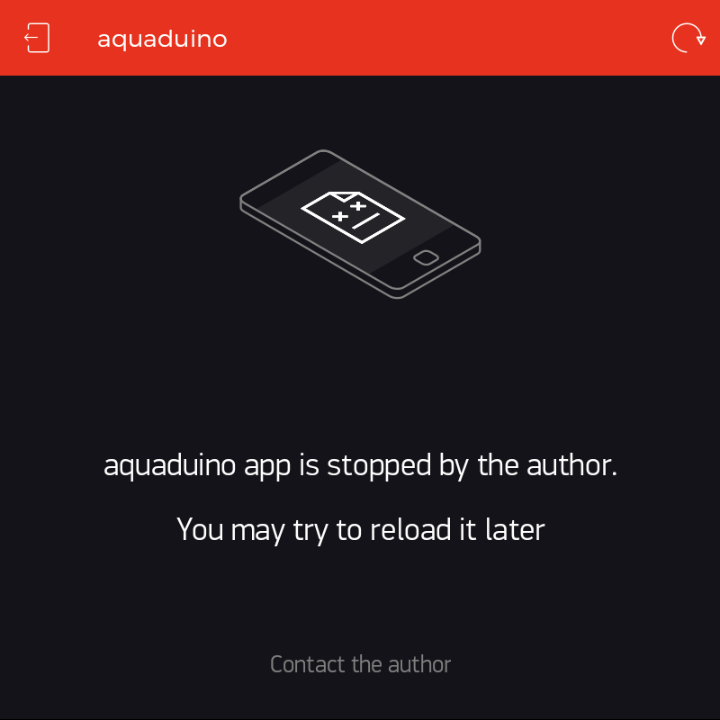

Hello, again one problem here. I have own blynk server and i want to share my project(that share that costs 1k energy). I pressed play button on my Main acc, and opened link in second Phone. But i get an error saying that the app is stopped by author(but it is turned on). So where’s the problem? What am i doing wrong?

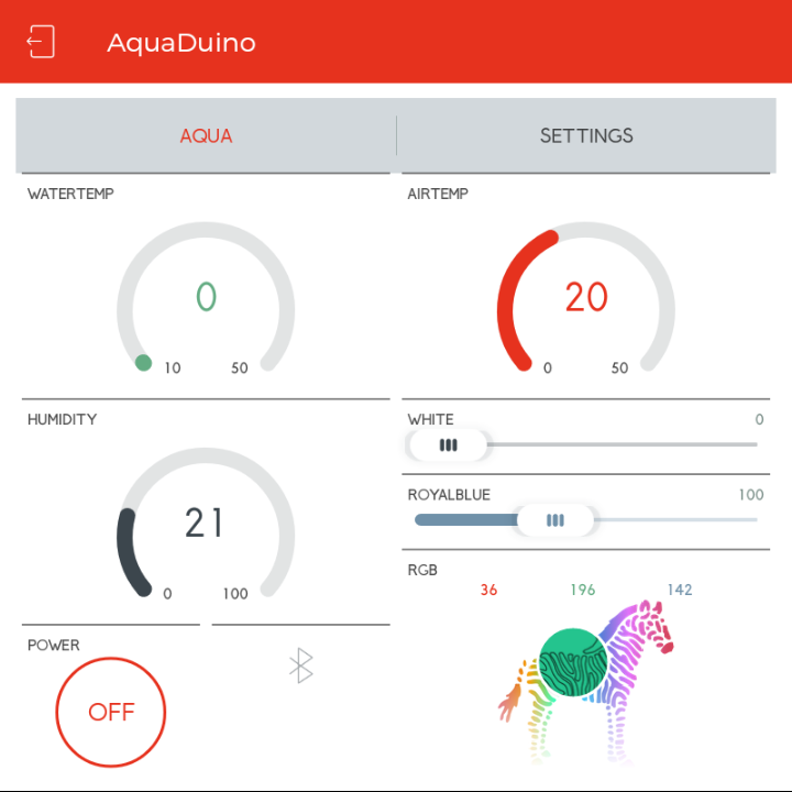

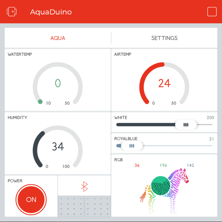

Also the second question, if i push values to splitted zergba pins, the widged doesnt show my value (works on sliders). It is known app bug, or i need to setup something in arduino?

OK i figured out where is my problem. At least i think so. When i have “paired” BT device(it says HC-06 connected) in BT widget it stops project when i close app. I unpaired BT and i was able to load shared app, but i cannot control anything of course, because it is not possible to connect BT device in shared app.
Oh… Sharing wasn’t suppose to work with BT. Sorry.
Oh, ok. Are you planning to make it work with BT at some time? Anyway thanks for yours fast replies. Can you please help me with that zeRGBa problem? I posted code here.
No. As BT is 1 to 1.

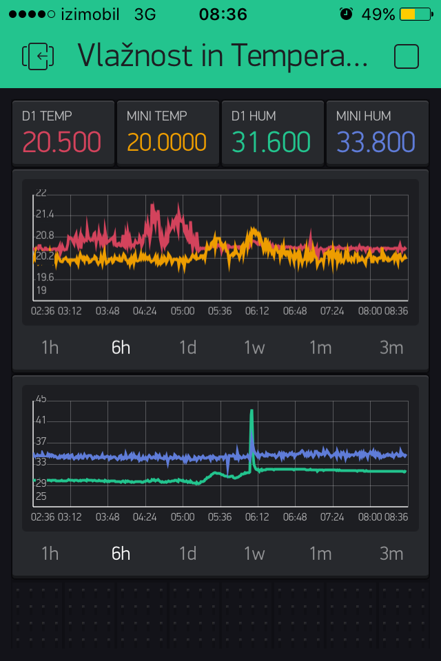

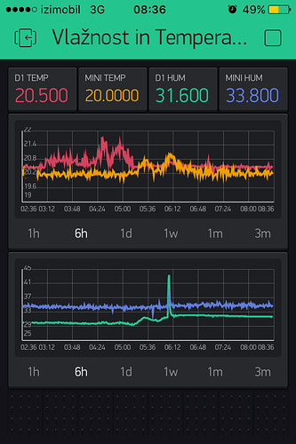

I am experiencing the same problem with sharing the project. I am not able to share the project to another android or ios device. Can be reason using Wemos D1 nad Wemos mini with the same token?
