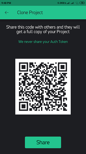

You will need to replace 3 display widgets with 3 terminal widgets and assign V5, V6, V7 pins to them. Here is the app layout
If it does not work I am at my wits end. Sorry, I couldn’t help !
