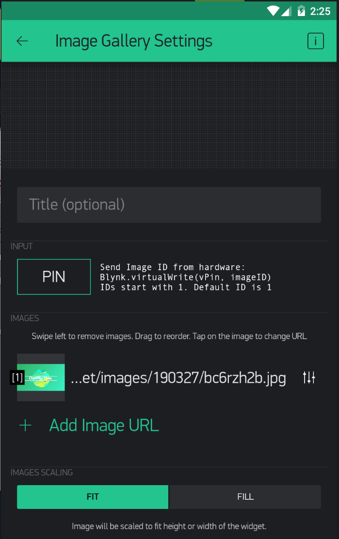

I try to upload a single Image For my blynk Programm.
It dosent need to be moving or something, it ist just the logo of my project.
I used a opensource upload side for pictures but alltime blynk says this url isnt supported.
Is there any other way to get my picture in the Programm instead of the widget Image gallery?

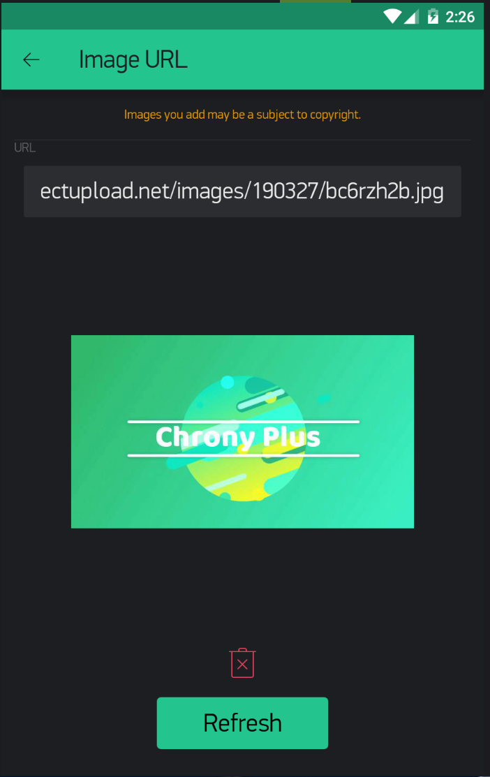

Snapshot_5
We need the URL to the image, not the actual image itself.
Oh okay sorry
https://www.directupload.net/file/d/5404/bc6rzh2b_jpg.htm
Based on the source code for that page, the URL you need is this…
https://s17.directupload.net/images/190327/bc6rzh2b.jpg
Thank you very much How did you do that
As for the URL, I just used the link you provided, right clicked in Chrome and chose View Page Source and found the actual image location URL in the HTML code.
