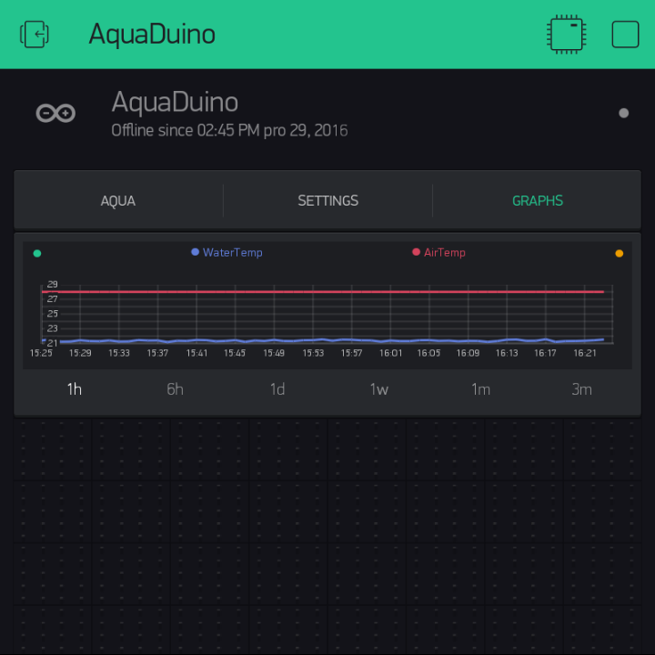

Hello, i’ve just noticed that the device view shows device as offline after some uptime, but the inputs/outputs works like a charm and app didn’t report Device is offline nor Device was disconnected. U can see that it is online by looking at history graph.
Also it magically repairs after some time and works again.

@Dmitriy Well, it is hard to tell when it happens, yesterday it occured at ~18:00, 2 days before at ~23:00 and today at ~14:00. I have my project running 24/7, and i can check temperatures by opening a blynk app. But sometimes when i open the app it shows me offline state in device view, but it is not. yep, newest version available.
