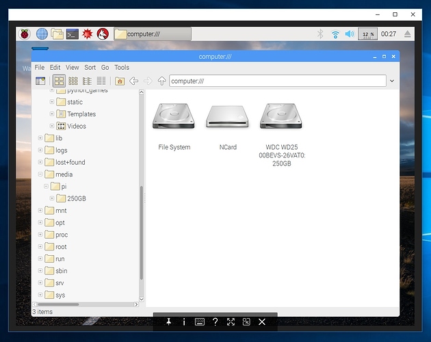

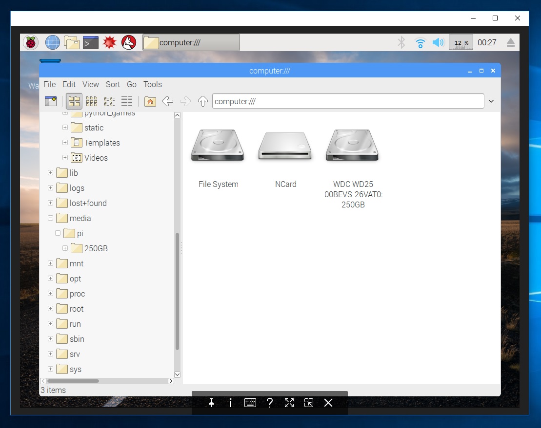

My Pi Zero W server now has a 250GB Western Digital hard drive. No idea why I did it, just had a few drives lying around. I guess it’s useful for something, right?
Attach it firmly to your little Zero to keep the Zero from floating away on a breeze (AKA paperweight)
Not quite what I was hoping for but that will do …
Well… it is just extra storage… way more than you could fill with projects (well, maybe in another month or so )
You could mess around with a NAS server, but the Zero is just a slow single core… so not really recommended for anything more then a possible learning process. Ditto with a Wordpress server.
