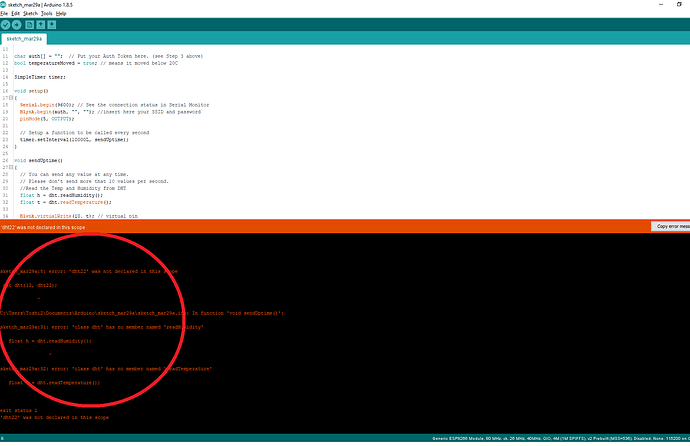

Hello there i have written code to notify me when temp goes down using wemos and dht22.
the code does not want to compile for some reason. other code compile and upload fine. i have changed cables. please help

it gives error compiling for board wemos d1 r2 and mini.
how is this Blynk related?
the error relates to your DHT.h library… work on that aspect…
kindly let me know how did you figure out that problem i was struggling with it for few hours and since i didnt get anywhere i thought i post for help. what do i need to do with dht.h library?
it tells you in the error messages in the compiler.
i have no idea, sorry!
in the arduino i have it only tells me error compiling for board wemos d1 r2 and mini. exit status 1 and error compiling for board wemos d1 r2 and mini.
if you can point exactly where it would show me error is related to dht.h library i wont ask dumb question like this these in future…:slight_smile:
Can you paste the copy of the entire error here?
yay! real help has arrived, i am outa here, byes!

how do i copy the entire error code? i only get the short version of error code.
Well, even the pasted short version would be better than a screenshot of text… I hate reading those :stuck_out_tongue_winking_eye: but thank you for the assist @Dave1829
In File -> Preferences you can checkmark Show verbose output during compilation
But… your posted code compiles just fine on my end, so I suspect you have a corrupt or missing DHT.h library
Build options changed, rebuilding all
In file included from C:\Users\Home\Documents\Arduino\libraries\DHT-sensor-library-master\DHT_U.cpp:22:0:
C:\Users\Home\Documents\Arduino\libraries\DHT-sensor-library-master\DHT_U.h:25:29: fatal error: Adafruit_Sensor.h: No such file or directory
 #include <Adafruit_Sensor.h>
compilation terminated.
exit status 1
Error compiling for board WeMos D1 R2 & mini.
where can i download a good version of dht library ? i went through couple of options but still no luck
There is your issue… you need to add this library as well.
i was showing WHERE to find the errors, not what the error was…
Well based on your prior answer I thought you were doing both… but as I didn’t read all of your screenshot, and my mind reading widget is broke again… I was unsure :stuck_out_tongue_winking_eye: But I stand corrected :smiley:
