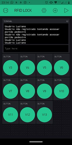

This code does not want to trigger the elock output, which can be, apparently there is nothing wrong.
I was also unable to include alexa.

  if (Credentials.credentials_get())
    Blynk.config(auth_token);
    connected_to_internet = 1;
    Credentials.setupAP(esp_ssid, esp_pass);
    connected_to_internet = 0;
  if (connected_to_internet)
  SPI.begin();      // Initiate  SPI bus
  mfrc522.PCD_Init();   // Initiate MFRC522 RFID
  myServo.attach(2); //servo pin D4
  myServo.write(0); //servo start position
  pinMode(LED_G, OUTPUT);
  pinMode(LED_R, OUTPUT);
  pinMode(BUZZER, OUTPUT);
  pinMode(elock,OUTPUT);
  digitalWrite(elock, HIGH);
  noTone(BUZZER);
  Serial.println("Place your card on the reader...");
  Serial.println();
  timer.setInterval(1000L, iot_rfid);
  Credentials.server_loops();
void iot_rfid()
  // Look for new cards
  if ( ! mfrc522.PICC_IsNewCardPresent())
    return;
  // Select one of the cards
  if ( ! mfrc522.PICC_ReadCardSerial())
    return;
  //Show UID on serial monitor
  Serial.print("UID tag :");
  String content= "";
  byte letter;
  for (byte i = 0; i < mfrc522.uid.size; i++)
     Serial.print(mfrc522.uid.uidByte[i] < 0x10 ? " 0" : " ");
     Serial.print(mfrc522.uid.uidByte[i], DEC);
     content.concat(String(mfrc522.uid.uidByte[i] < 0x10 ? " 0" : " "));
     content.concat(String(mfrc522.uid.uidByte[i], DEC));
  Serial.println();
  Serial.print("Message : ");
  content.toUpperCase();
  // defining cards here
  if( (content.substring(1) == "id card") && (aflag == 1) ) //change the UID of the card/cards that you want to give access
    Serial.println("Usuário Luciano");
    Blynk.virtualWrite(V2, "Usuário Luciano" );
    Serial.println();
    delay(500);
    digitalWrite(LED_G, HIGH);
    delay(3000);
    digitalWrite(elock, LOW);
    tone(BUZZER, 500);
    delay(250);
    noTone(BUZZER);
    digitalWrite(LED_G, LOW);
 if( (content.substring(1) == "id card") && (bflag == 1) ) //change the UID of the card/cards that you want to give access
    Serial.println("Usuário Cassia");
    Blynk.virtualWrite(V2, "Usuário Cassia" );
    Serial.println();
    delay(500);
    delay(3000);
    tone(BUZZER, 500);
    delay(250);
    noTone(BUZZER);
 if( (content.substring(1) == "id card") && (cflag == 1) ) //change the UID of the card/cards that you want to give access
    Serial.println("Usuário Larissa");
    Blynk.virtualWrite(V2, "Usuário Larissa " );
    Serial.println();
    delay(500);
    delay(3000);
    tone(BUZZER, 500);
    delay(250);
    noTone(BUZZER);
 if( (content.substring(1) == "id card") && (dflag == 1) ) //change the UID of the card/cards that you want to give access
    Serial.println("Usuário Samuel");
    Blynk.virtualWrite(V2, "Usuário Samuel " );
    Serial.println();
    delay(500);
    delay(3000);
    tone(BUZZER, 500);
    delay(250);
    noTone(BUZZER);
 if( (content.substring(1) == "id card") && (eflag == 1) ) //change the UID of the card/cards that you want to give access
    Serial.println("Usuário Michael");
    Blynk.virtualWrite(V2, "Usuário Michael " );
    Serial.println();
    delay(500);
    delay(3000);
    tone(BUZZER, 500);
    delay(250);
    noTone(BUZZER);
 if( (content.substring(1) == "id card") && (fflag == 1) ) //change the UID of the card/cards that you want to give access
    Serial.println("Usuário Keith");
    Blynk.virtualWrite(V2, "Usuário Keith " );
    Serial.println();
    delay(500);
    delay(3000);
    tone(BUZZER, 500);
    delay(250);
    noTone(BUZZER);
 if( (content.substring(1) == "id card") && (gflag == 1) ) //change the UID of the card/cards that you want to give access
    Serial.println("Usuário Silvana");
    Blynk.virtualWrite(V2, "Usuário Silvana " );
    Serial.println();
    delay(500);
    delay(3000);
    tone(BUZZER, 500);
    delay(250);
    noTone(BUZZER);
 if( (content.substring(1) == "id card") && (hflag == 1) ) //change the UID of the card/cards that you want to give access
    Serial.println("Usuário Cicero");
    Blynk.virtualWrite(V2, "Usuário Cicero " );
    Serial.println();
    delay(500);
    delay(3000);
    tone(BUZZER, 500);
    delay(250);
    noTone(BUZZER);
 if( (content.substring(1) == "id card") && (iflag == 1) ) //change the UID of the card/cards that you want to give access
    Serial.println("Usuário Osvaldo");
    Blynk.virtualWrite(V2, "Usuário Osvaldo " );
    Serial.println();
    delay(500);
    delay(3000);
    tone(BUZZER, 500);
    delay(250);
    noTone(BUZZER);
 if( (content.substring(1) == "id card") && (jflag == 1) ) //change the UID of the card/cards that you want to give access
    Serial.println("Usuário Manuel");
    Blynk.virtualWrite(V2, " Usuário Manuel " );
    Serial.println();
    delay(500);
    delay(3000);
    tone(BUZZER, 500);
    delay(250);
    noTone(BUZZER);
 if( (content.substring(1) == "11 88 130 162") && (lflag == 1) ) //change the UID of the card/cards that you want to give access
    Serial.println("Usuário Suelen");
    Blynk.virtualWrite(V2, "Usurio´Suelen " );
    Serial.println();
    delay(500);
    delay(3000);
    tone(BUZZER, 500);
    delay(250);
    noTone(BUZZER);
 else {
    Serial.println("unregistered user");
    Blynk.virtualWrite(V2, "Usuário não registrado tentando acessar portão pedestre " );
    Serial.println(" Access denied");
    digitalWrite(LED_R, HIGH);
    tone(BUZZER, 300);
    delay(1500);
    digitalWrite(LED_R, LOW);
    noTone(BUZZER);
// in Blynk app writes values to the Virtual Pin 3
BLYNK_WRITE(V3)
   aflag = param.asInt(); // assigning incoming value from pin V3 to a variable
BLYNK_WRITE(V4)
   bflag = param.asInt(); // assigning incoming value from pin V4 to a variable
BLYNK_WRITE(V5)
   cflag = param.asInt(); // assigning incoming value from pin V5 to a variable
BLYNK_WRITE(V6)
   dflag = param.asInt(); // assigning incoming value from pin V3 to a variable
BLYNK_WRITE(V7)
   eflag = param.asInt(); // assigning incoming value from pin V7 to a variable
BLYNK_WRITE(V8)
   fflag = param.asInt(); // assigning incoming value from pin V8 to a variable
BLYNK_WRITE(V9)
   gflag = param.asInt(); // assigning incoming value from pin V9 to a variable
BLYNK_WRITE(V10)
   hflag = param.asInt(); // assigning incoming value from pin V10 to a variable
BLYNK_WRITE(V11)
   iflag = param.asInt(); // assigning incoming value from pin V11 to a variable
BLYNK_WRITE(V12)
   jflag = param.asInt(); // assigning incoming value from pin V12 to a variable
 BLYNK_WRITE(V13)
   lflag = param.asInt(); // assigning incoming value from pin V13 to a variable

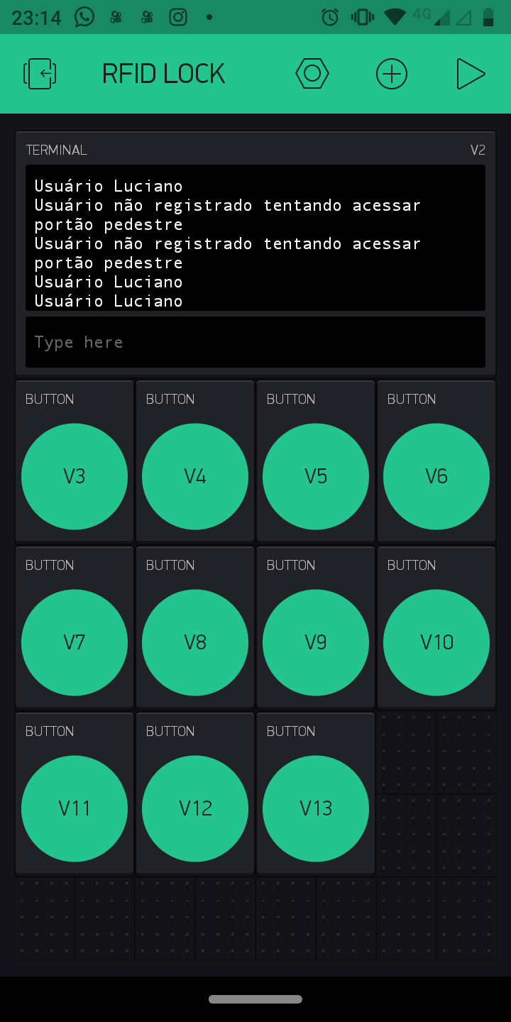

App image.
You seem to be missing lots of pinMode statements in your void setup.
You also seem to be combining random sketches with very little understanding of how any of them work. At this point, you’re not even on the topic that @PeteKnight created for you.
