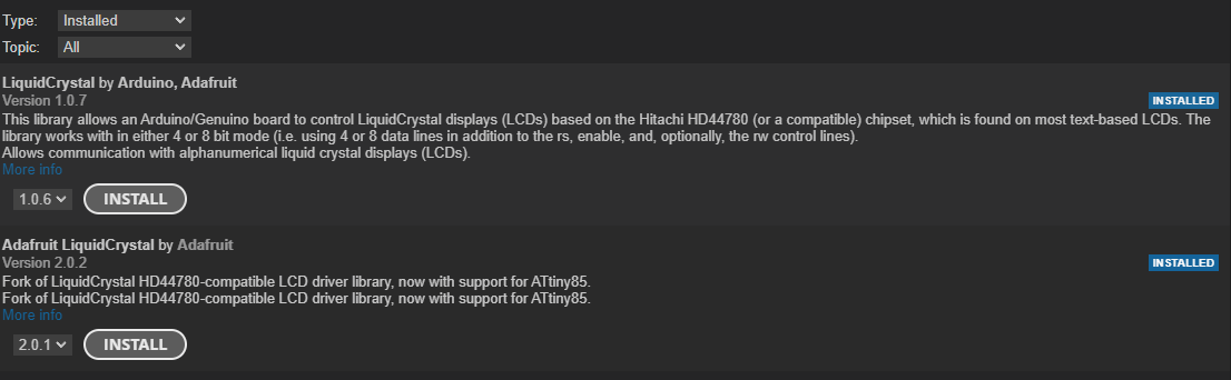

So I’m confused about where the Adafruit library you mentioned earlier fits-in to the equation.

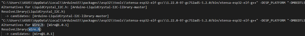

When you compile the code and it lists the libraries used, does it mention the Adafruit library, and does it say that version 1.0.7 of this library was used?
I need to see more of that message for it to be meaningful, and at the end of the compilation - before the upload - it should list the libraries used. I’d like you to copy that in full.
