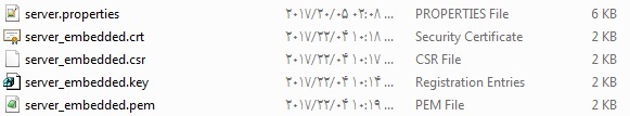

i made 4 cert files with names
and place on root directory of server is it correct?

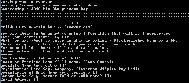

when i set server host local host server i get this error
when i try this:
Generate own SSL certificates
    openssl req -x509 -nodes -days 1825 -newkey rsa:2048 -keyout server.key -out server.crt
  • Convert server.key to PKCS#8 private key file in PEM format
    openssl pkcs8 -topk8 -inform PEM -outform PEM -in server.key -out server.pem
If you connect hardware with USB script you have to provide an option ā€˜-s’ pointing to ā€œcommon nameā€ (hostname) you did specified during certificate generation.
As an output you’ll retrieve server.crt and server.pem files that you need to provide for server.ssl properties.
what is this information? what should i enter?
:expressionless:
:expressionless:
Do you need your own certs?
Is your local server exposed to the internet?
Why not use the default certs that have recently become available?
If you need your own then enter your details at the relevant command prompts like name, email etc.
Yes
Yes
is that dosent matter what i typed?
Not really important.
