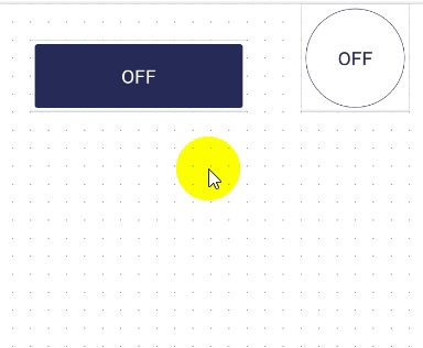

Moving widget failed
Android 10 and 7 , amazing widget :thinking:
Video_2021-10-25_180423
Yep it’s annoying… you have to hold the widget long and move a lot around to get it sort of to the place you want. Changing the size and work to the place were you want it works faster…

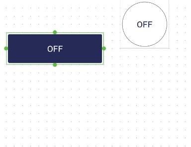

I know how to workaround , but it’s a bug to be solved , so we have to report it :wink:
Video_2021-10-25_182542
I know, just confirming the issue :wink:

@Blynk_Coeur Is it dashboard with tabs? It seems I’ve been able to reproduce something similar only in dashboard just after adding tabs.
“I’m also missing an auto insert function to place a new widget between two old ones.” - can you provide more details on this issue, is it smth about adding a widget from widgets menu?
Yes I use tabs
I just tried without tab , moving widgets work.:thinking:
Got it, looks like I’ve fixed it, there should be a new version till the end of the week - it will contain this fix.
