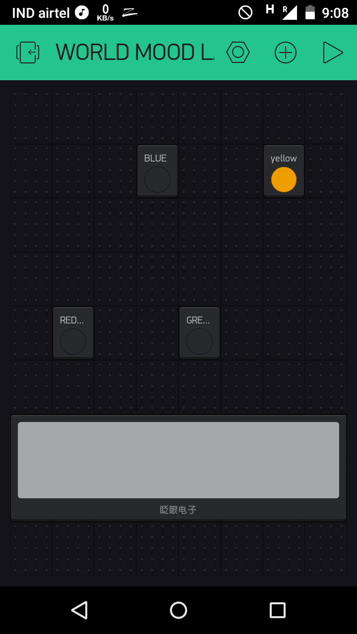

WidgetLED led(V1);
void send()
 if (analogRead(A3) != 0) {
    led.on();
   pinMode(A3,INPUT); // trigger for green
   Blynk.begin(auth);
   timer.setInterval(1000L, send);

Do i have write all the conditions in the void send() function?
Like all the analogwrite statements?

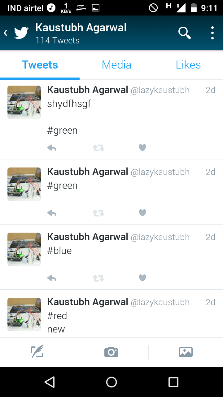

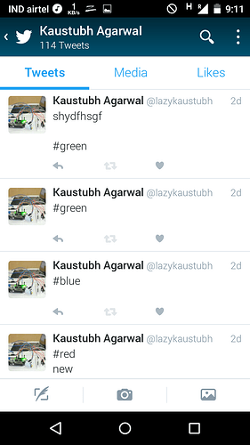

@Dmitriy I got this part working. But there is a problem with IFTTT. It’s not picking up my latest tweet but rather a series of them. So my lamp is switching colors instantaneously, which is ruining all the fun. Do you know what is their interval of checking?

Suppose I have this system.
For a single tweet only one LED should light up but The system is switching between the ultimate and the pen-ultimate tweets. I have assigned each trigger word in tweet to a particular LED.
Only one led should light up at a particular time but this is not happening. I have a video to show that but I can’t attach it here.
