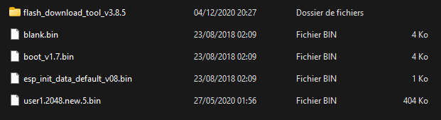

Hi Pete.
The ESP device I use is ESP8266/ESP-07. I updated the firmware with the following files:
Below the information sent by the device for each query:
