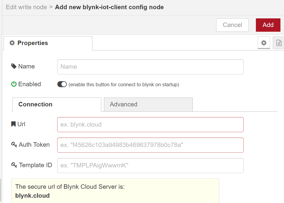

But I think there currently is no way to dynamically set the template id and auth token on a ‘blynk write’ node red node?
Is there a way to make what I want?
I’m not aware of a way to dynamically create a configuration node from external data.

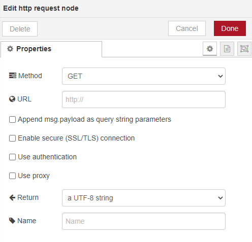

If I do not choose “enable secure (SSL/TLS) connection”
and call this url:
https://blynk.cloud/external/api/batch/update?token=authtoken&v250=123460&v251=2022-12-03&v252=2022-12-09
I get:

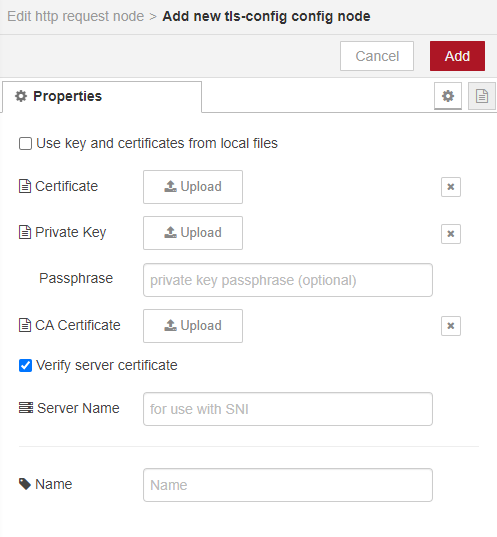

If I enable “enable secure…” I have to setup a TLS config and add certificates…???

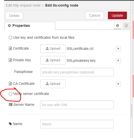

I added the certificates of my server to Node red, still did not work until I unselected “verify server certificate”
After deleting the certificates I uploaded and leaving the “verify server certificate” unchecked it kept on working
This works for me…
