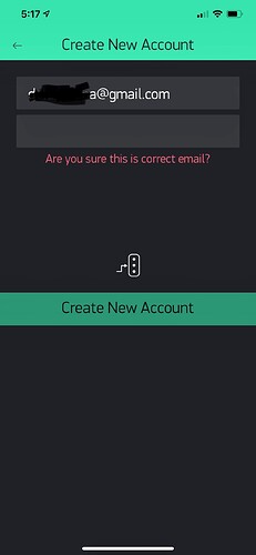

Some screenshots might help
Here are two screenshots, correction one screenshot*. The passwords were filled in at the time of the screenshot but the image capture did not capture the passwords even though the passwords were already obscured by dots.
In one case the email address is questioned. In the other case the Create New Account submit bar is not highlighted so not clickable.

Setting up an account “through the website” is only possible with Blynk 2.0 (Blynk IoT).
Your screenshot shows the Blynk 0.1 (Blynk Legacy) app sign-in screen. The IoT and Legacy apps connect to different servers, and you can’t use the Legacy app to sign-in to the IoT system and vice-versa.
