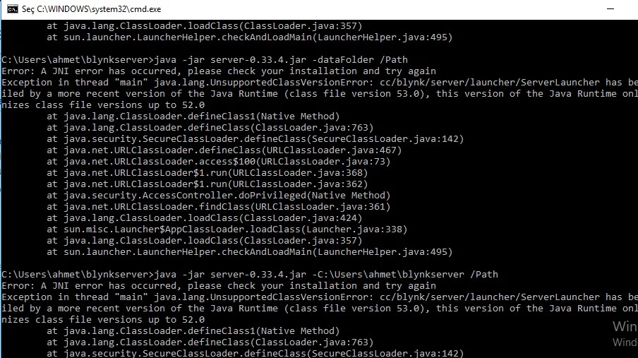

whats the wrong. and i cant find blnyk local server setup on wın 10 OS.
https://i.hizliresim.com/z0ZzXD.jpg
https://www.youtube.com/watch?v=XJNzjH-bYsA this tutorial useful but i cant

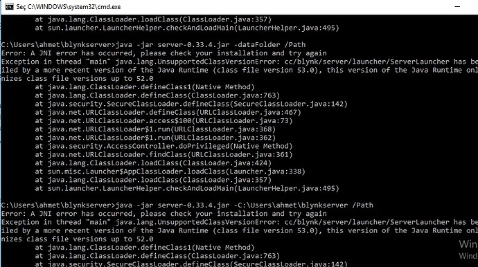

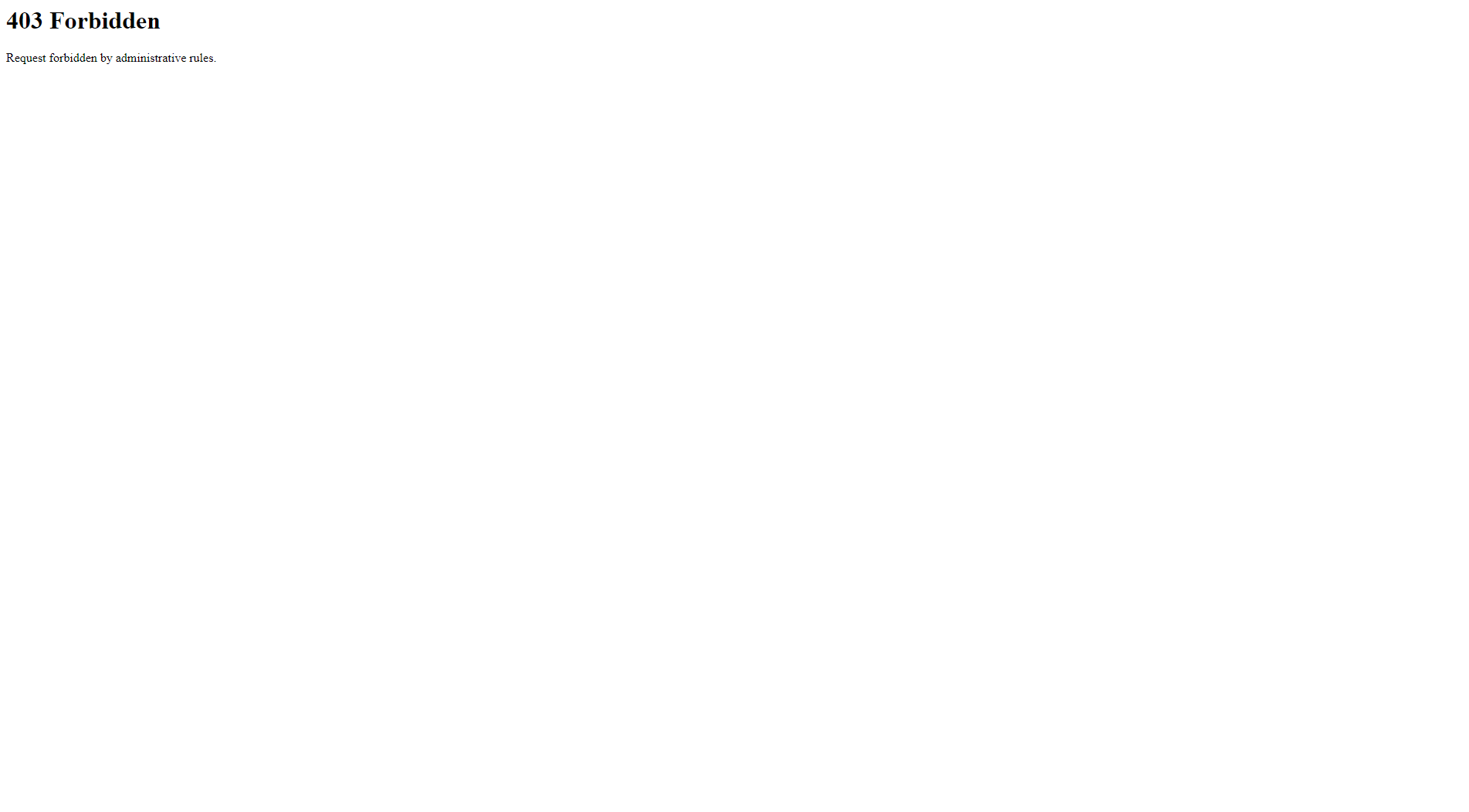

Hmm… Is this the problem, you are having with server?
Because that is what i saw after clicking the first link…
You are using wrong java version. You need java 9 or use another server version with -java8
