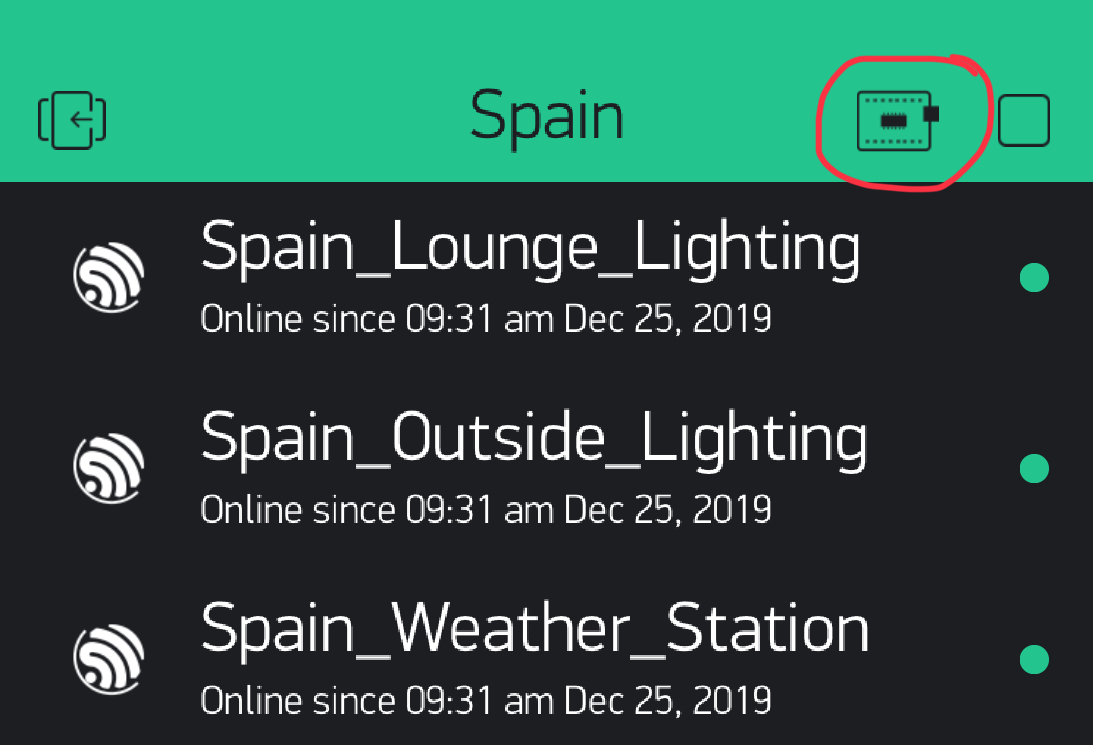

Online/offline status of each device in your project is shown in the status bar at the top of the screen…
If you add a Notification widget you can get notifications when a device goes offline.

You could use the BLYNK_CONNECTED() callback to send a notification to say that the device is online.
