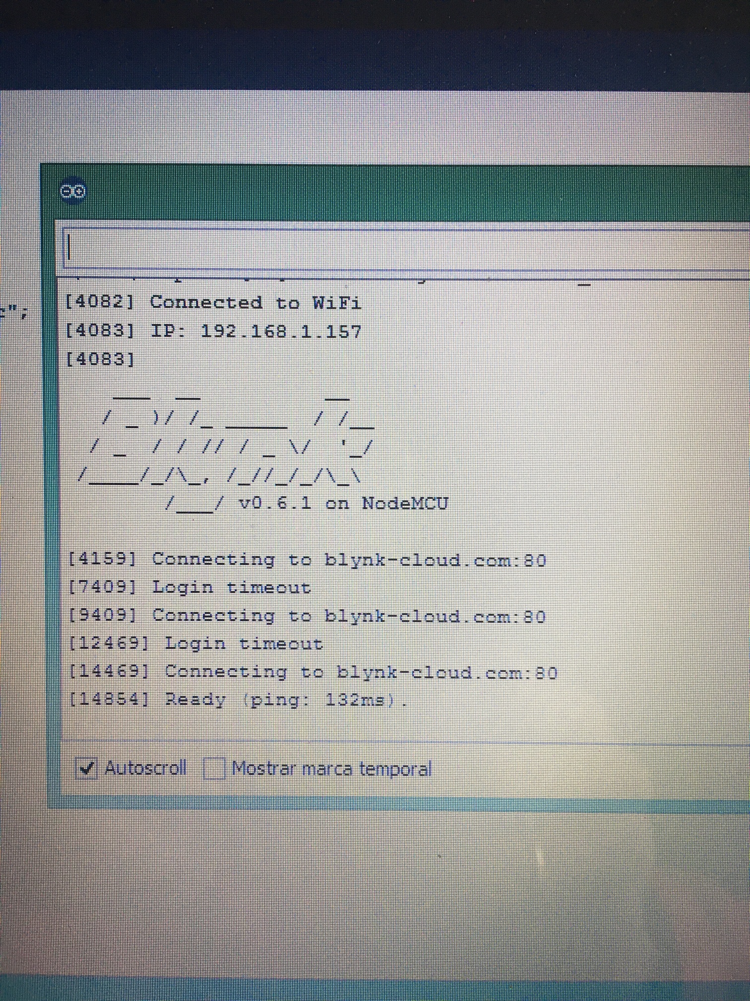

My monitor serial is baud rate 9600. When the board is connected I can see:
I have connected a led in the digital pin D1 (GPI05) and the blynk is selected the virtual pin V2, as my sketch. You can see that in BLYNK_WRITE(V2) is put Serial.println (a) and in the serial monitor I never see it.
Thanks in advance.
The serial monitor:
