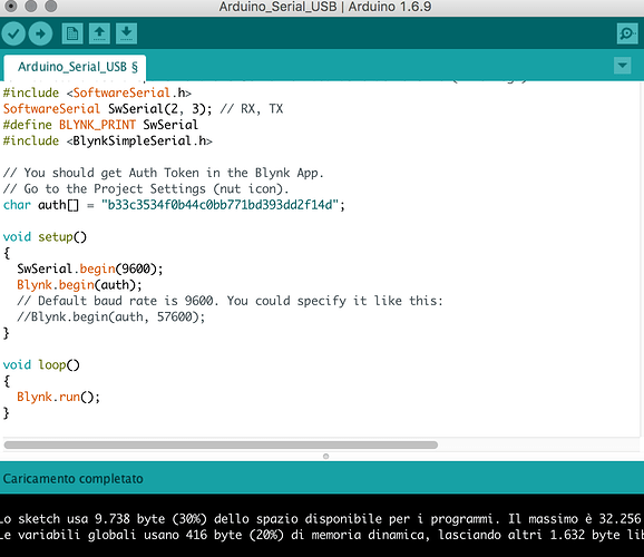

Once the example has opened, i have changed the token with the same of the app, then compiled end loaded on arduino. (the sketch is attached)
I’m simply trying to switch on a single led which is connected to the digital Pin8.

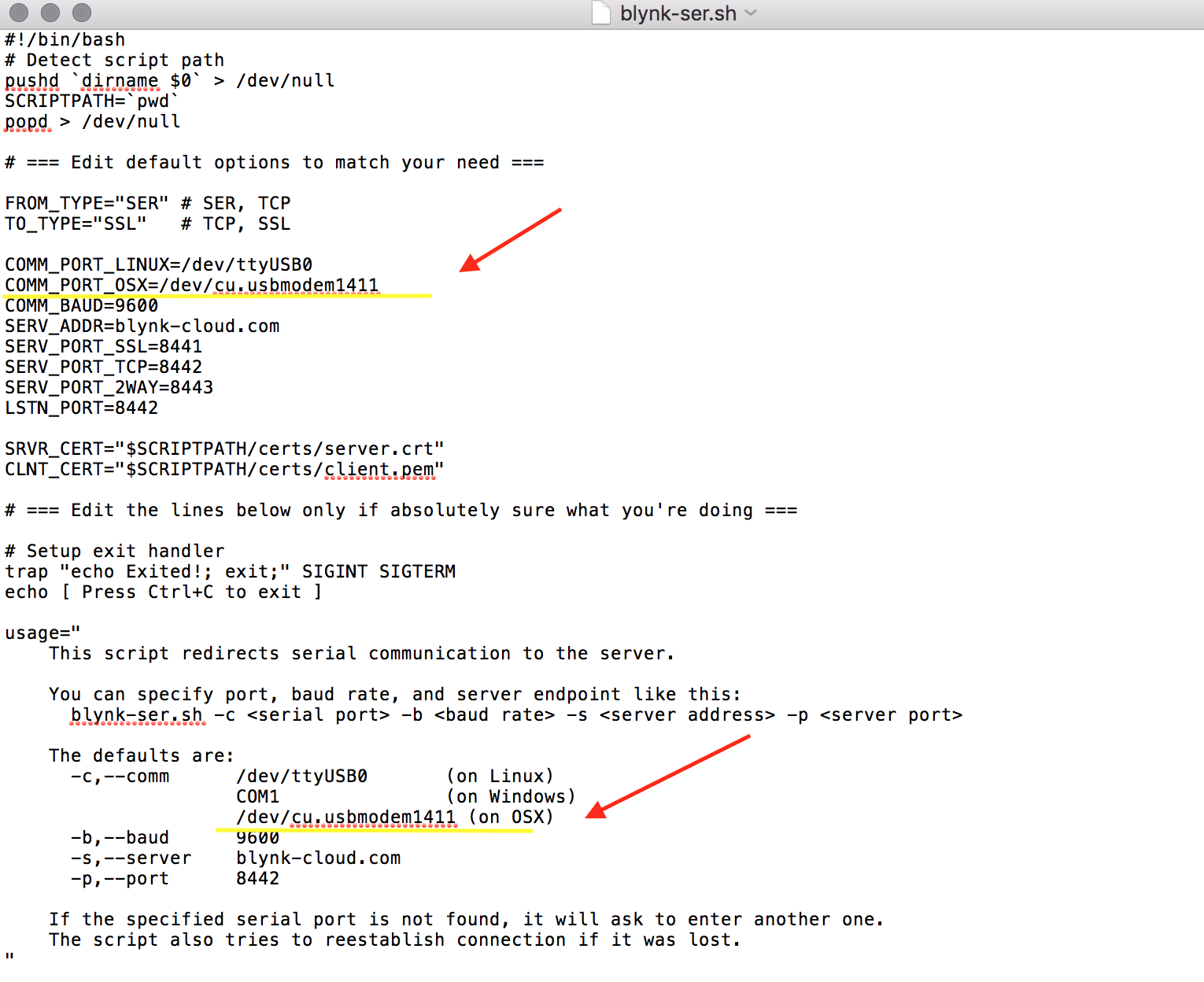

I didn’t manage to start the file blynk-ser.sh from the terminal since after doing sudo ./blynk-ser.sh it doesn’t allow me writing the password, so I opened the file with textedit and changed the parameters which are highlighted with /dev/cu.usbmodem1411 as shown in arduino’s IDE.

here what I’ve tried to change in ā€œblynk-ser.shā€
thank you

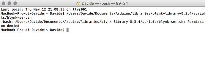

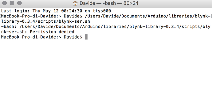

If i drag the file to the terminal it says this (without sudo) :

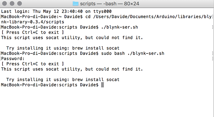

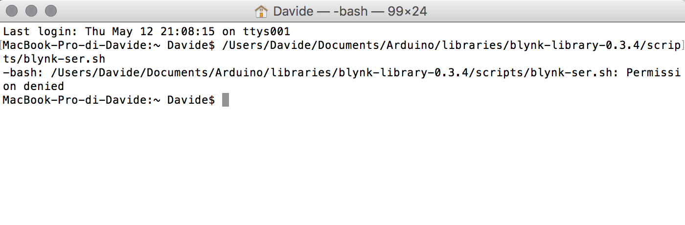

This is what it does from the terminal with sudo. Maybe i’ve red that Mac doesn’t show the password on the right of the key even if you are typing for ā€œsecurity mattersā€, but also typing the correct password it shows this:
You need to be in scripts directory in order to run ./blynk-ser.sh

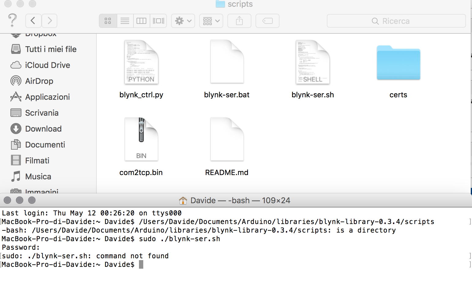

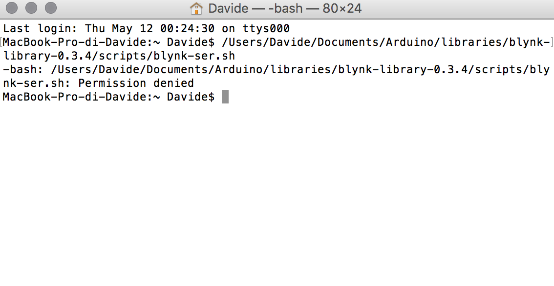

I’m not in the directory as I showed you? If i drag the file blynk-ser.sh in the terminal it says these:
I don’t know. You tell me. You need to ā€œcdā€ to folder with script and after that run it with your ā€œsudo ./slynk-ser.shā€
how about sudo bash ./blynk-ser.sh ?
Now it says this…what is socat? do I need to install it? :disappointed_relieved:
@Dave27 I thought ā€˜install socat’ had been added to the notes in the Arduino_Serial_USB example but I don’t see it.
Yes you need to install socat.

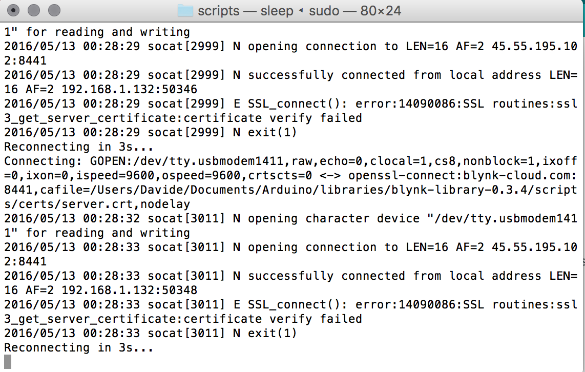

Yes, thank you, noi I have installed socat and it says this: (now I think it is a problem of my router?)
Maybe I have understood that it tries to use the port 8441 which is the SSL one? it gives problem about SSL certification. but I don’t care to use it, I can use the 8442… but is it possible to change it?
It looks like a problem with security certificates on port 8441, try tcp on 8442.
8442 should be the default as stated in blynk-ser.sh but I think you may have edited it incorrectly. Add # at the start of the lines:
SERV_PORT_SSL=8441
SERV_PORT_2WAY=8443
Actually this is a bug that is fixed already. Just get the latest version from the master branch.
