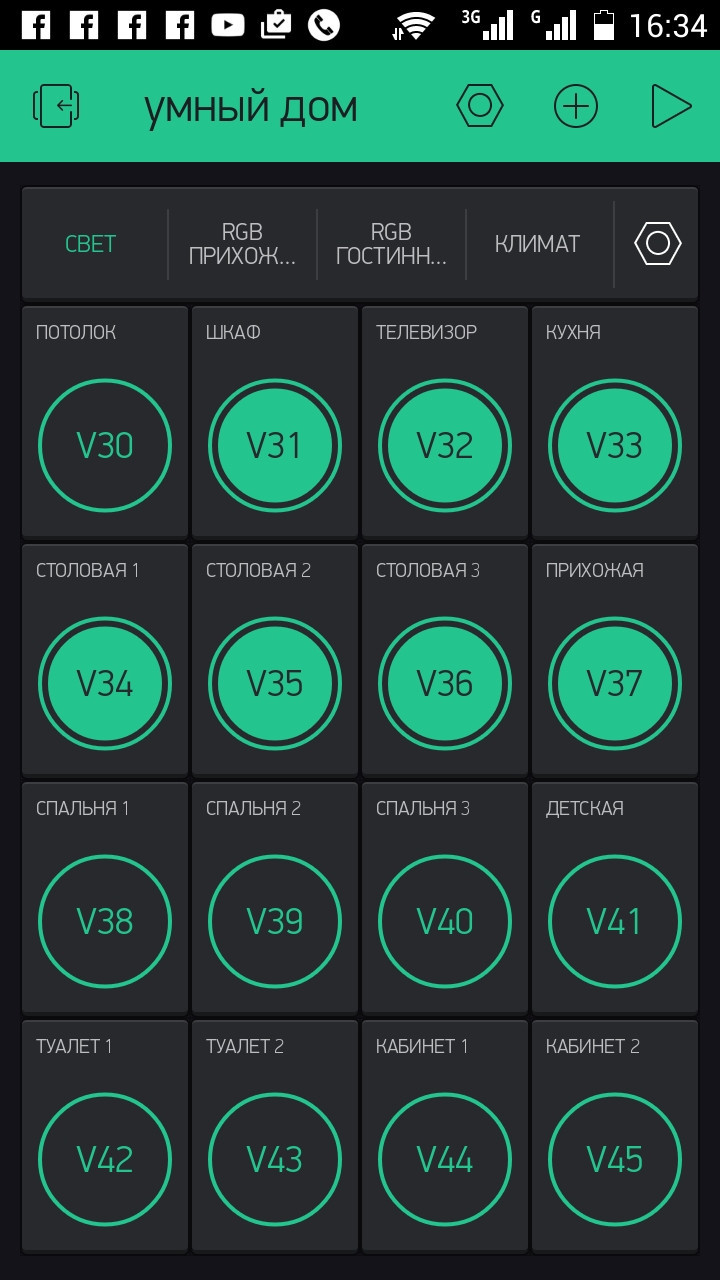

can someone has the code, Arduino Mega, which would control 22 buttons widget and connected 22 physical buttons to widgets?
@Sergey_Kuntsevich i have given the sample code, you can replicate or expand the code to next inputs switches and outputs. by renaming like example “RelayPin1” “RelayPin2” so on and so forth.
@speed57 thesame what you need. he got already… Cheers guys…
code (without arrays), but blynk can not handle more than 10 virtual pin and 10 attached physical buttons.

@Sergey_Kuntsevich hi guys, ill give you good technique, first of all you have to build 1 complete function for example you need (22 outputs) (22 Physical hardware inputs switch) and (22 Blynk widget switch both are linked to input and outputs)
you must start from 1 means you have to identify which pin number you are going to use for input pins and which pin you are going to use for output pins.
you can use analog pin from A4 to A15 as input only and 21 to 53 you can define as you wish either input or output to cover up your 22 inputs and outputs. free digital pins from D2-D9 and analog pins A0-A3 utilize it for some other functions. D10,D11,D12,D13 reserved this pins if you are using Arduino Ethernet shields.
next is building the sketch. Create 1 sketch for 1 input 1 output and 1 Bynk widget, test it. once it is success then do it to next pin, copy paste the code just change the pin name’s, make it simple only. don’t take it in one shot.
if I knew how to write this function, I would not be sitting here
You will be able to add the code function?
@Sergey_Kuntsevich okill help you out for this, ill give you at least 5inputs, 5outputs and widget as well. but may be tomorrow ill take a look you code and send you back. this time already late in my place. its 12:11am Lol i feel sleepy now. but no worry ill help you too.
by the way what is your hardware’s used? cam you share. ex mega2560 ehthernet shield relay modules and what type of input switch you want to use, is it normal push button sw, normally open or normally close, toggle switch or same like our standars lighting switch. let us know.
good night ill get back to you tomorrow…
mega2560 ehthernet W5100,
relay normally used in Example normally closed.
I will had very grateful to you, and I think other people as well. Tk my code ever written it is very large and can not work as blynk can not handle more than 10 widgets and 10 physical buttons.
@Sergey_Kuntsevich isaw something in your sketch im revising it now.
can you send your widget screen shot because checked my phoneit is 16 push button widget total can fit per screen, you can use additional tab widget to accommodate all buttons you need.
@Sergey_Kuntsevich please try to upload the revised code.
