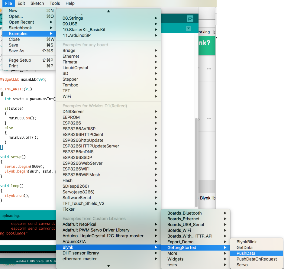

Please take a look at the PushData example. It contains everything you need to accomplish that.
whrer I can find Push Data example?
In the Blynk library examples, in the Arduino IDE.
