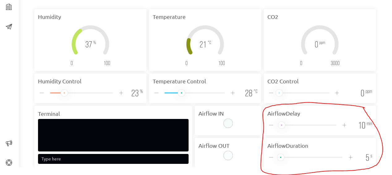

@PeteKnight Thank you for helping me! I’ve just tried to run the code. Unfortunatly I get an compilation error.

  Serial.print("        Airflow - duration set by user at: ");
  Serial.print(airflowduration);
  Serial.println("sec");
//BLYNK_WRITE (V7)
  Serial.print("        Airflow - delay set by user at: ");
  Serial.print(airflowdelay);
  Serial.println("min");
  Serial.println(" ");

  128    void Airflow()    //swiches Fans on and off for a certain time
  129 {
  130     digitalWrite(27, HIGH);     //swiches fan1 on
  131     digitalWrite(12, HIGH);     //swiches fan2 on
  132     Serial.println();
  133     airflowduration = * 1000;     //    <------- Here is the error
  134     Serial.print("In void Airflow - airflowduration in ms = ");
  135     Serial.print(airflowduration);
  136      Serial.println(" Timer starting");
  137
  138      timer.setTimeout(airflowduration, []()
Surgeon :slight_smile:
Replace line 133 for:
airflowduration = airflowduration * 1000;
Give it a try…
Regards
Actually, Line 133 should be deleted altogether, as I’m doing the multiplication of the value here, in BLYNK_WRITE(V6)
Line 133 got deleted.
Serial Monitor:
15:27:43.366 -> [9021] Using Dynamic IP: 192.168.0.48
15:27:43.366 -> [9021] CONNECTING_NET => CONNECTING_CLOUD
15:27:43.366 -> [9031] Connecting to blynk.cloud:443
15:27:44.334 -> [9976] Certificate OK
15:27:44.379 -> [10018] Ready (ping: 40ms).
15:27:44.544 -> BLYNK_WRITE(V4)triggered - incoming value = 35
15:27:44.575 -> BLYNK_WRITE(V5)triggered - incoming value = 28
15:27:44.662 -> BLYNK_WRITE(V6)triggered - incoming value = 12
15:27:44.662 -> airflowduration in ms = 12000
15:27:44.705 -> Setting timer to 12000 ms
15:27:44.705 -> [10359] CONNECTING_CLOUD => RUNNING
15:27:44.749 -> BLYNK_WRITE(V7)triggered - incoming value = 22
15:27:44.749 -> airflowdelay in ms = 22000
15:27:56.707 ->
15:27:56.707 -> In void Airflow - airflowduration in ms = 12000 Timer starting
15:28:08.722 ->
15:28:08.722 -> In void Airflow - airflowduration in ms = 12000 Timer starting
15:28:08.722 -> Timer complete - AIRFLOW OFF FOR 22000 ms
15:28:08.722 ->
15:28:20.718 ->
15:28:20.718 -> In void Airflow - airflowduration in ms = 12000 Timer starting
15:28:20.718 -> Timer complete - AIRFLOW OFF FOR 22000 ms
15:28:20.718 ->
15:28:32.710 ->
15:28:32.710 -> In void Airflow - airflowduration in ms = 12000 Timer starting
15:28:32.710 -> Timer complete - AIRFLOW OFF FOR 22000 ms
15:28:32.710 ->
15:28:44.729 ->
15:28:44.729 -> In void Airflow - airflowduration in ms = 12000 Timer starting
15:28:44.729 -> Timer complete - AIRFLOW OFF FOR 22000 ms
15:28:44.729 ->
15:28:56.721 ->
15:28:56.721 -> In void Airflow - airflowduration in ms = 12000 Timer starting
15:28:56.721 -> Timer complete - AIRFLOW OFF FOR 22000 ms
15:28:56.721 ->
15:29:08.685 ->
15:29:08.685 -> In void Airflow - airflowduration in ms = 12000 Timer starting
15:29:08.732 -> Timer complete - AIRFLOW OFF FOR 22000 ms
I tried it. It does not work unfortunatly
Surgeon
You appear to have modified my code (other than adding-in the missing Blynk credentials and library #includes). Why?
Also, why is your serial output double-spaced?
I had your and my code side to side and copied the parts of yours ypu have changed into mine. I was doing this because I try to learn and I thought that would be the best way to do so. :slight_smile:
Anyways, I made a new sketch with your code + the missing parts (1-50):

I just changed airflowdurationto 5000ms and airflowdelayto 10000ms. I kept running your script for about 30min. During that time i came across those outputs in the serial monitor.

No, that wasn’t the reason why every line of serial output, including those generated by the Blynk debug routine were double spaced.
Can you clarify the code changes you made to achieve this please?
Also, take care to use the correct characters when posting code. These aren’t triple backticks…
I changed it on the blynk web dashboard. Not in the code
I edited the post :slight_smile:
I don’t understand.
ok :confused:
i changed it back to your orignal code. What causes the double spacing?

when I run your code, thats the serial monitor after booting:
18:02:45.925 -> [11132] Connecting to blynk.cloud:443
18:02:47.455 -> [12663] Certificate OK
18:02:47.501 -> [12705] Ready (ping: 40ms).
18:02:47.626 -> BLYNK_WRITE(V4)triggered - incoming value = 23
18:02:47.671 -> ->BLYNK_WRITE(V4)
18:02:47.671 -> Blynk custom settings:
18:02:47.671 ->
18:02:47.671 ->         RH: 23%BLYNK_WRITE(V5)triggered - incoming value = 28
18:02:47.717 -> ->BLYNK_WRITE(V5)        Temp: 28°C
18:02:47.796 -> BLYNK_WRITE(V6)triggered - incoming value = 5
18:02:47.796 -> airflowduration in ms = 5000
18:02:47.842 -> Setting timer to 5000 ms
18:02:47.842 -> [13045] CONNECTING_CLOUD => RUNNING
18:02:47.842 -> BLYNK_WRITE(V7)triggered - incoming value = 10
18:02:47.842 -> airflowdelay in ms = 10000
18:02:52.820 ->
18:02:52.820 -> In void Airflow - airflowduration in ms = 5000Timer starting
18:02:57.798 ->
18:02:57.843 -> In void Airflow - airflowduration in ms = 5000Timer starting
18:02:57.843 -> Timer complete - AIRFLOW OFF FOR 10000 ms
18:02:57.843 ->
18:03:02.803 ->
18:03:02.803 -> In void Airflow - airflowduration in ms = 5000Timer starting
18:03:02.803 -> Timer complete - AIRFLOW OFF FOR 10000 ms
18:03:02.850 ->
18:03:07.823 ->
18:03:07.823 -> In void Airflow - airflowduration in ms = 5000Timer starting
18:03:07.823 -> Timer complete - AIRFLOW OFF FOR 10000 ms
18:03:07.823 ->
18:03:12.828 ->
18:03:12.828 -> In void Airflow - airflowduration in ms = 5000Timer starting
18:03:12.828 -> Timer complete - AIRFLOW OFF FOR 10000 ms
18:03:12.828 ->
18:03:17.822 ->
18:03:17.822 -> In void Airflow - airflowduration in ms = 5000Timer starting
18:03:17.822 -> Timer complete - AIRFLOW OFF FOR 10000 ms
18:03:17.822 ->
18:03:22.833 ->
18:03:22.833 -> In void Airflow - airflowduration in ms = 5000Timer starting
18:03:22.833 -> Timer complete - AIRFLOW OFF FOR 10000 ms
I changed the values for the airflowdelay and airflowduration on the web dashboard.
So I assume that this should have read…
I just changed the widget attached to datastream V6 to 5 and V7 to to 10 via the web dashboard?
If so, what’s the significance of these numbers compared top the previous ones, and what’s the significance of the serial monitor output that you posted after this comment?
Yes, that is what i meant. I try to be more exact next time :slight_smile:
I think there is no significance to those numbers compared to the previous ones either to the second serial monitor.
What are the next steps?
Thank you for your help Pete, I appreciate that very much! :pray:
