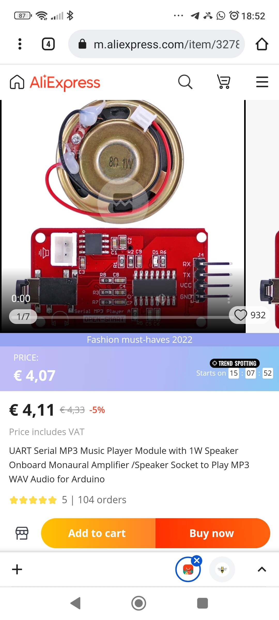

You sey that i need a mp3 controlled by MCU, and a scheduler that controll the play button?
Like this one?
Messages that you speak into the phone, or pre-recorded messages?
Both. When my dog is eating than a recorded message will sound. And if i wont to send him something when im at work or something than live ones. I orded that mp3 i send in the previous message, i hope it wasn’t a mistake

Im making a college project for a smart housing system for dogs. And it needs to be cheep and practical.
Im using Blynk for controlling threw the wifi.
When the dog is eating i want to play a music for him and also send him voice messege. I think alexa and petcam colud be expensive and a little bit cheating because i need to make everything by myself you see.
So esp32cam will be my video device and i purchase that mp3 player:
inbound468298812289508302
Now i need to figure it out how to control them both with the Blynk app…
