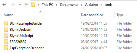

The one I use is the .zip file from here:
If it’s not showing in the IDE after closing all of the IDE sessions and restarting, then you’ve probably installed it incorrectly.
If your sketch folder is Documents → Arduino then it should look like this:
