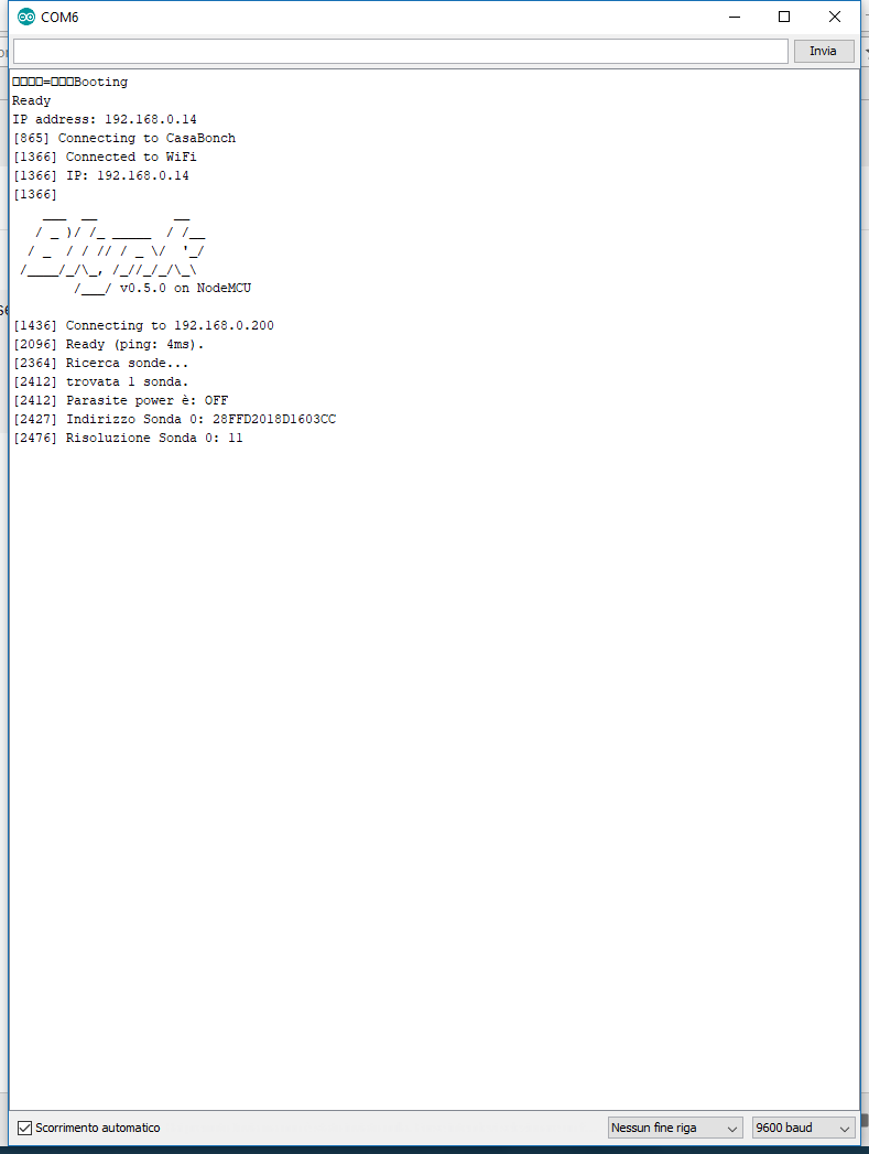

Hi, I tried to search on the forum but I’m still confused. I loaded this sketch on NodeMCU and I received on serial (photo 1)… So I think it’s right.

now what I have to do?
Modify the sketch “export demo / template esp8266”?
is it enough to change the “template_esp8266” section as I did with the arduinoOTA sketch?
Thank!
If all you want to do is have OTA facility then you should be finished now.
If you look at the ports available in the Arduino IDE you should now see the IP address of ESP.
2 things to remember, must have Serial Monitor closed when you do an OTA and after any Serial updates to the ESP (not OTA updates) you must reset the ESP before OTA will work.
thank you because I did not know it.
It appears
if it is possible, I would like to load the sketch on the server and make sure that the hardware is updated automatically
Yes that’s possible. This is the basic code you need https://github.com/esp8266/Arduino/blob/master/libraries/ESP8266httpUpdate/examples/httpUpdate/httpUpdate.ino
And some docs to study https://arduino-esp8266.readthedocs.io/en/latest/ota_updates/readme.html#http-server
