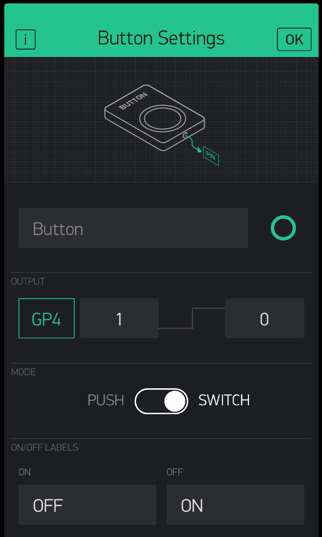

As soon as I launch my project button attached to gpio4 turns on that represents low state of the pin u should give a choice to whether when the project is launched the button is turned on or off

Well, in effect you are given this option, by swapping the 0/1 for a 1/0 and swapping ON/OFF for OFF/ON
I didn’t mean this I have swapped 1 with 0 and 0 with one but the button turns on ( becomes coloured to be precise )

but what about the problem that only one switch turns on by itself and others dont
It may have something to do with the App Preview you created and linked to the project. Try erasing the App Preview located in My Apps.
I would not create an App preview until you have finished the project, and got everything working as it should.
