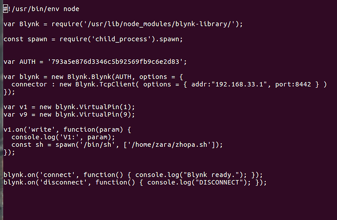

Ok post the following:
  1. Bash script that calls the client from rc.local
  2. Your js Blynk client file
  3. The bash script

my 1.js - blynk client file, i dont warry about token shown… it will be deleted
blynk.sh ’ is to show that # exist)))
