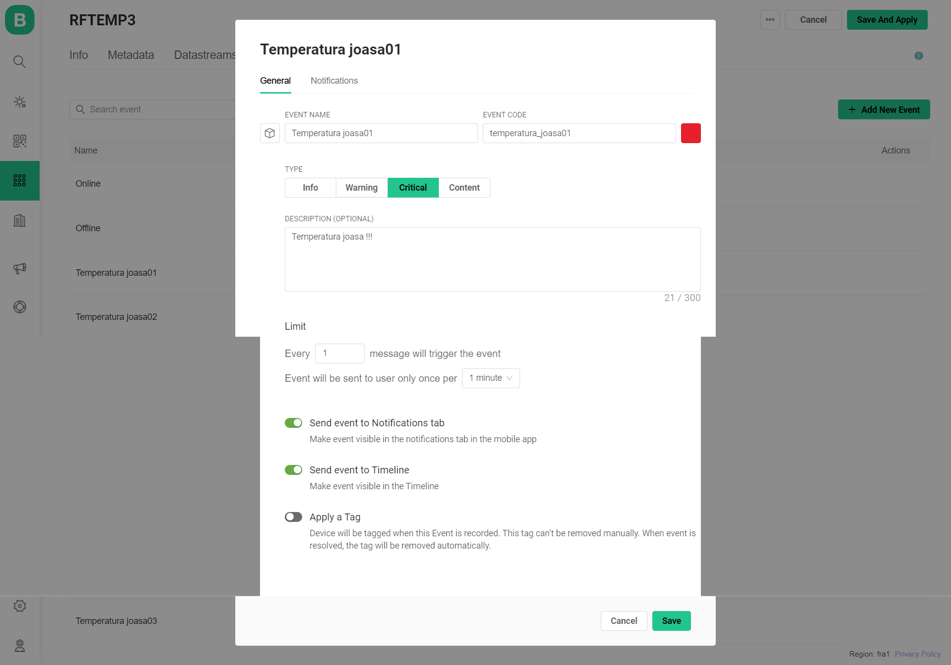

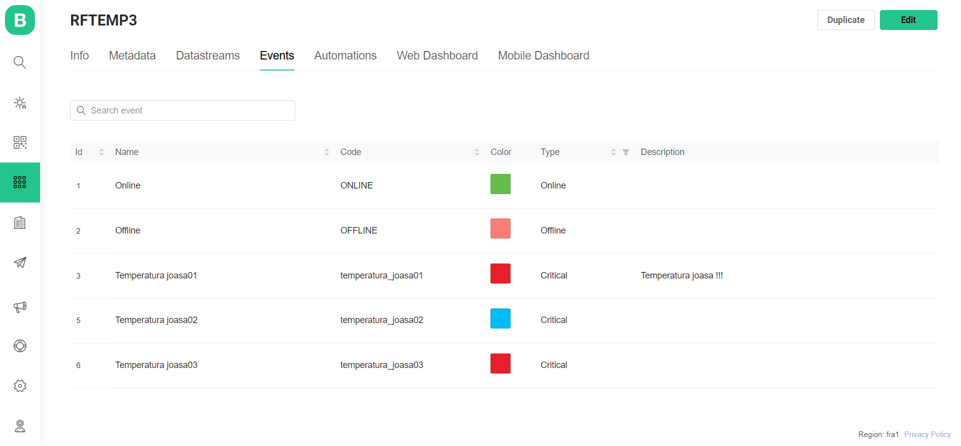

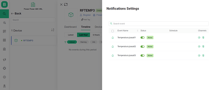

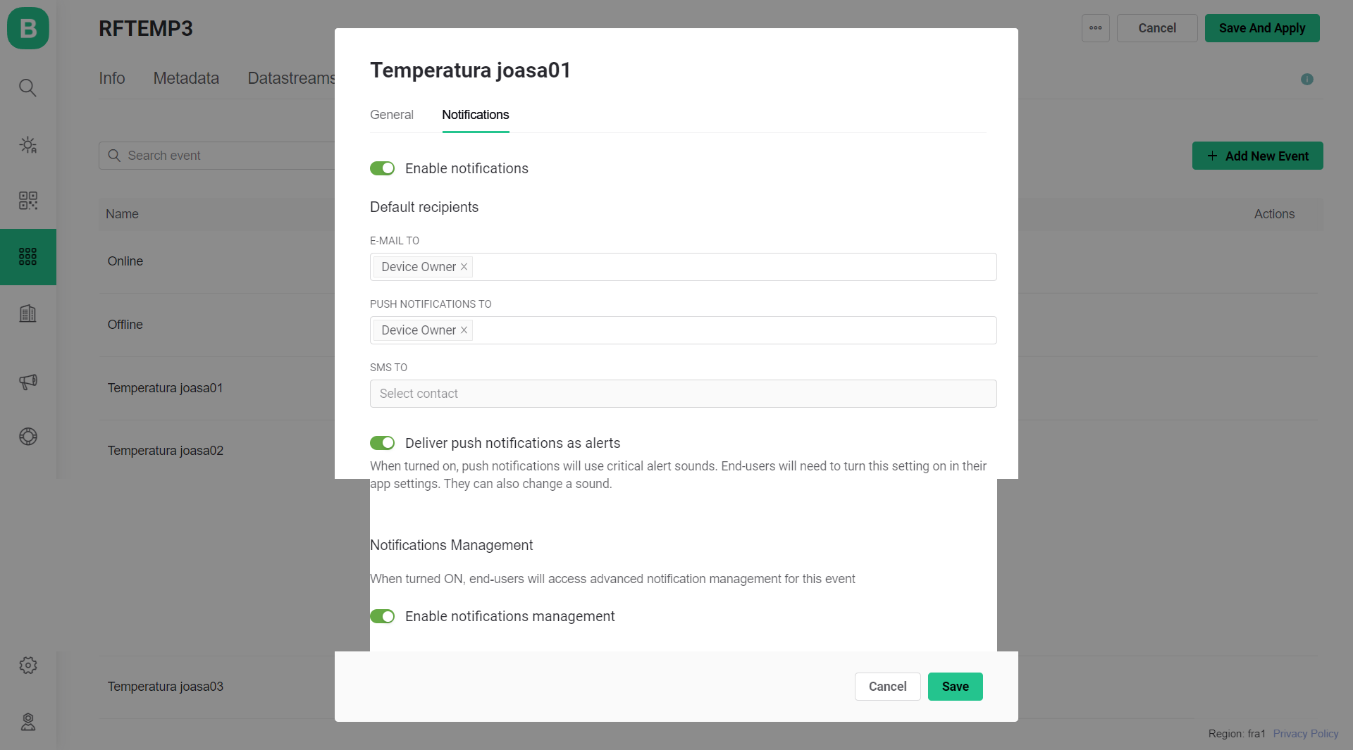

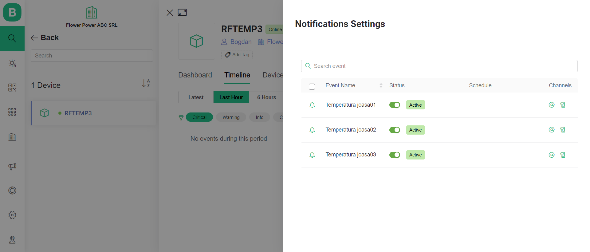

Without details of exactly how you’ve configured each of your events and the corresponding notifications tabs, and how the Notifications settings in the device view (three dots in the web console next to the device name) are configured, then its difficult to say.
Thanks Pete for fast response. I will put some printscreen.
