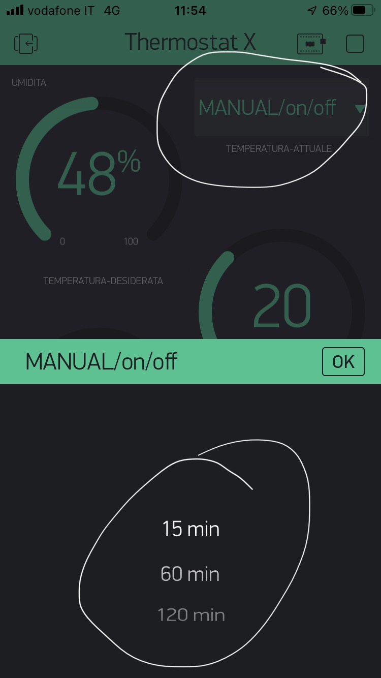

Sarebbe interessante un Manual 15/60/120
You can use segmented switch :thinking:
