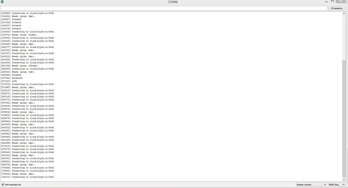

Log of my connection is below.

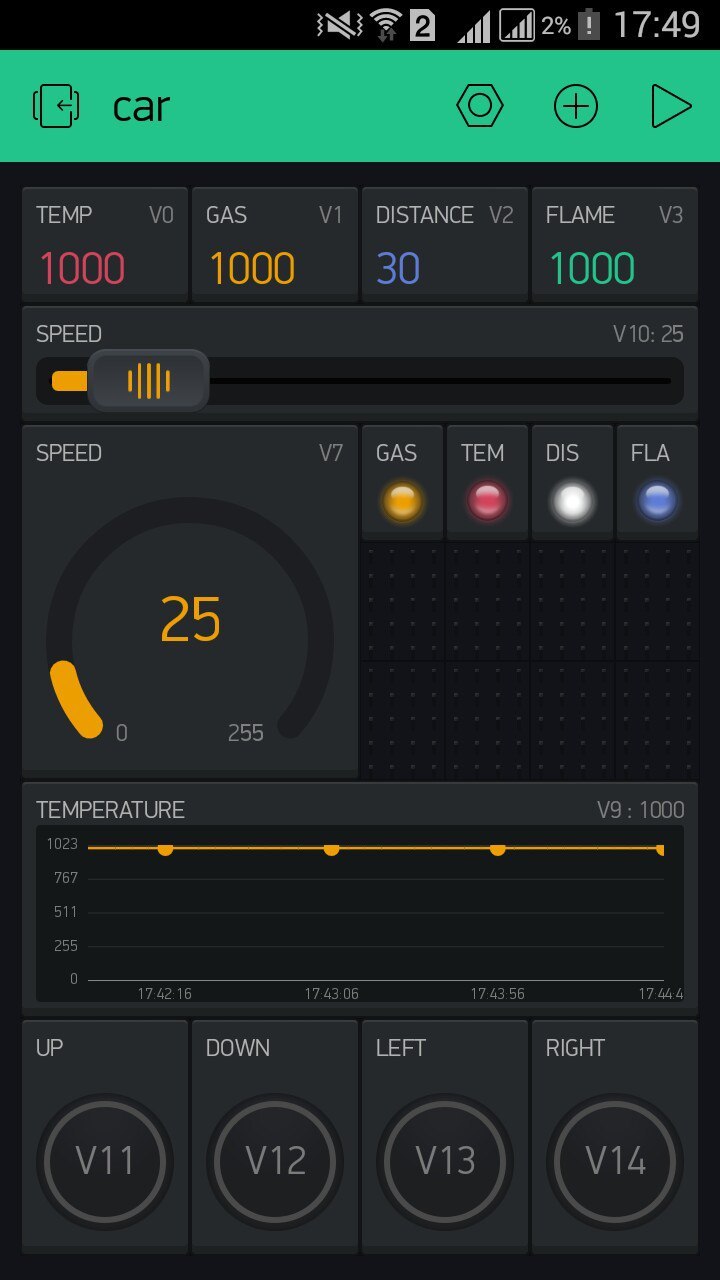

Also interface of my profile.
Maybe you’re sending to much data at a time… all your timers align on 5 second interval, so it produces bursts of data…
Then how can i send data not sumultaneously but 1 transaction after another?
You can send data at different time intervals,
Overall, you don’t need that much timers, why?
You can do it in one (or two)
First you do not need the timer function duplicated. One Simpletimer can handle multiple timers (I believe 10).
and yes you send to many values. I experienced same problems as well.
Hint 1: Use one Simpletimer:
If you want to have all data sent after the 5s you send too much.
in Setup:
timer.setInterval(5000L, senddata1); timer.setInterval (6000L, senddata2); timer.setInterval(11000L, senddata3);
in the loop
Hint 2: for LEDs you might want to save the status (Alarm_last_reading in my example and only send data if the LED changes
such as:
if (!alarm_movement && Alarm_last_reading) { Blynk.virtualWrite(ALARM_LED,0); Alarm_last_reading = 0; } else { if (alarm_movement && !Alarm_last_reading) { Blynk.virtualWrite(ALARM_LED,1); Alarm_last_reading = 1; }
Thank you for your detailed explanation.
You wrote about (Alarm_last_reading and alarm_movement). Are these standard functions of blynk library?
No, they are variables, they contain data generated by something (sensor, or whatsoever).
