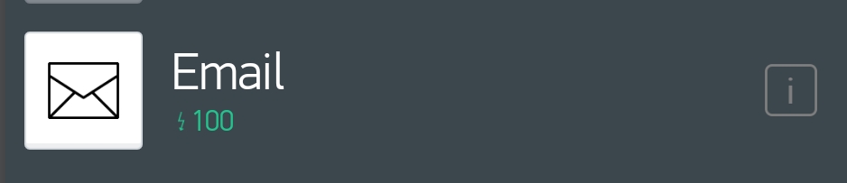

Do you have the email widget on your Blynk project?
No. I just want to send email to my mail address.
You need to add
Into your project.
Also your code will send several emails while cel>20 . Blynk will only send 1 email every 15 sec and is limited to 100 Messages per day.
