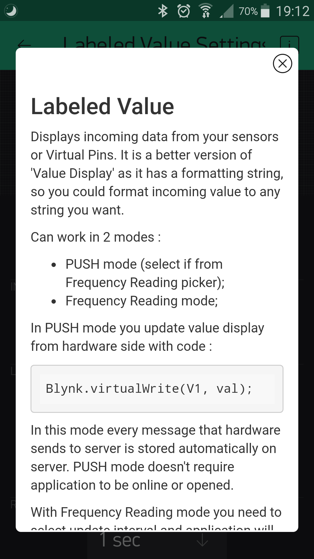

before trying to costumise the decimals, try to READ the docs attached to each widget:
on each widget setting page, there is a small “i” in the upper right corner of the screen. if you click that, it reveals useful info about that widget. check the “labeled value” widget.
It worked!! Thank you for the information abaut the little i
you’re welcome. hope you will use it in the future, it is very handy :wink:
