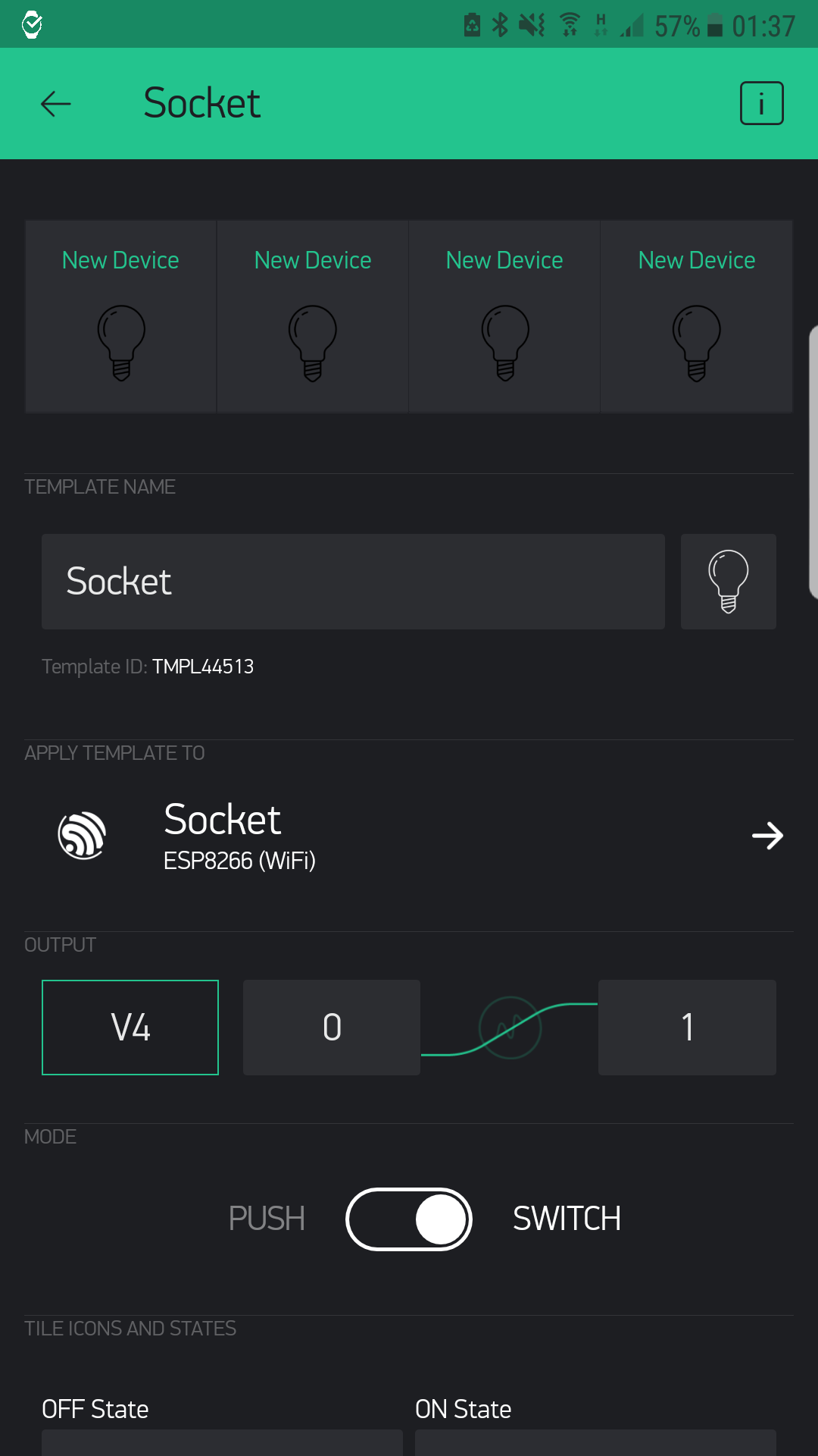

This the button tile template. It triggers the V4. Inside the sketch V4 simply triggers the relay.

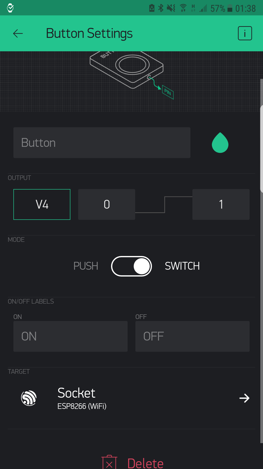

And this is the V4 button. They both triggers the relay. Just can’ t synchronise them.
This is not supported currently
Ok…
