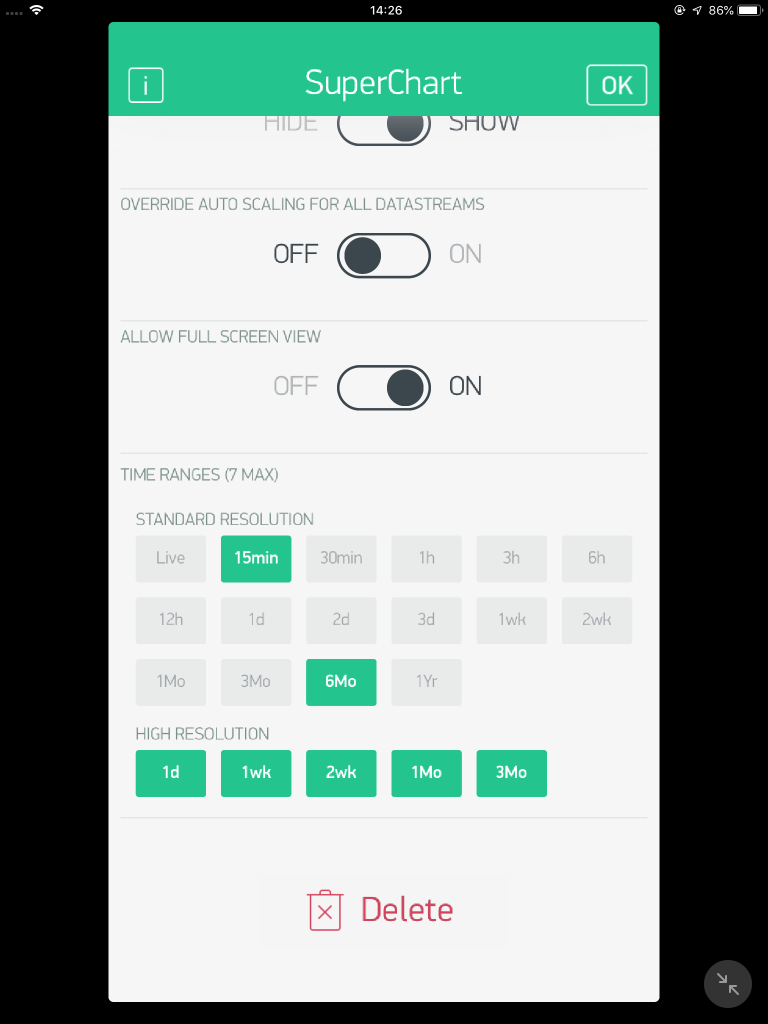

Have you looked st the high resolution and standard resolution display settings:
You should also read this:
especially the bit towards the end of the Superchart section that talks about granularity.

4)Then, educating myself by looking at the web, it seems that these settings are accessed via … (dot dot dot) at the bottom right of each chart:

The settings in the screenshot I posted are accessed when the app is in stopped mode. If you’re using a shared copy of the app then you may not have access to stop the project. With full access it’s done using the square Stop button in the top right hand corner of the app.

At this point I would like to thank you for your help above, attached images and links. By simply changing the resolution we got far more useful renderings of the temperature data for the cabin.
I am trying to attach an example AFTER adjusting resolutions in the SuperWidget.
