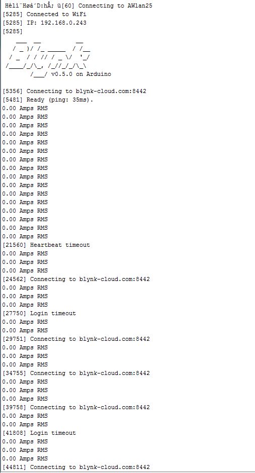

I have some issues with the WMos D1.
First it connects to the WLan and to the Blynk server but after a view seconds it disconnects from the server
and starts the Connection process again.
I don´t know where is my mistake and I never had this issue maybe someone knows how to solve!

It’s not the Wemos D1 that’s the problem, it’s your code.
You’re trying to take a voltage reading from the ACS712 module every time void loop runs, then send a Blynk notification.
Void loop should be running hundreds, if not thousands of times per second (although it won’t in this case as you have far too much code being evaluated/executed in each void loop cycle).
You need to use a timer to call the voltage reading function, at a sensible frequency (once per second, or once per minute maybe) and just have Blynk.run and timer.run in your void loop.
You can only send notifications once every 15 seconds, so if you need to use notifications you need to create some logic to manage that process. Personally, i doubt that notifications are the best thing to use - far better to update a value widget with the appropriate message text.
