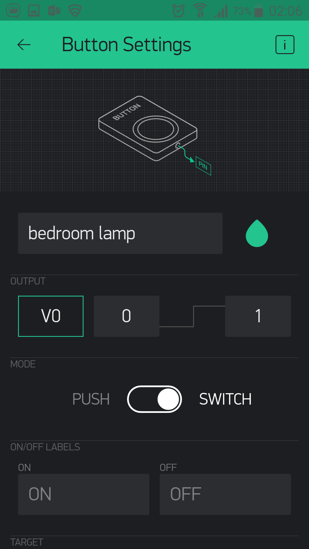

2 devices are identical in hardware both ESP-01 using GPIO2 controlling 2 lamps
kitchenlamp
bedroomlamp
TAG is named kitchenbedroom

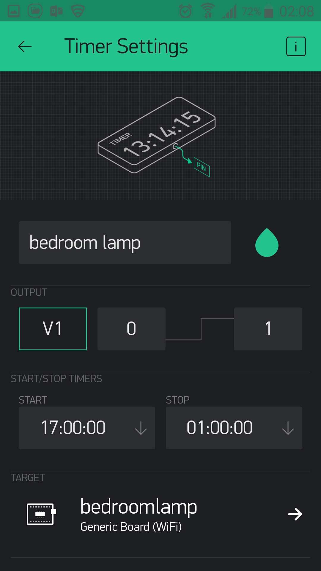

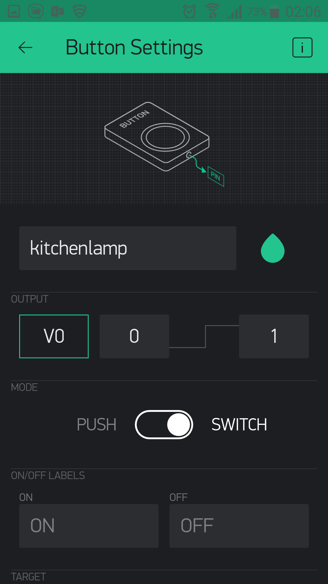

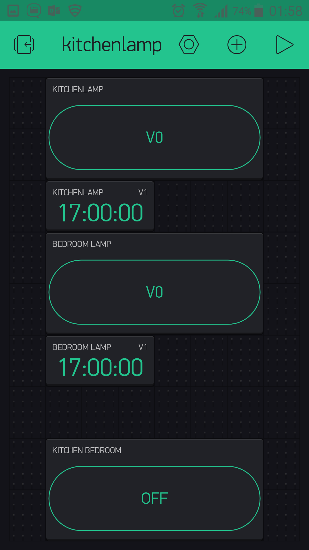

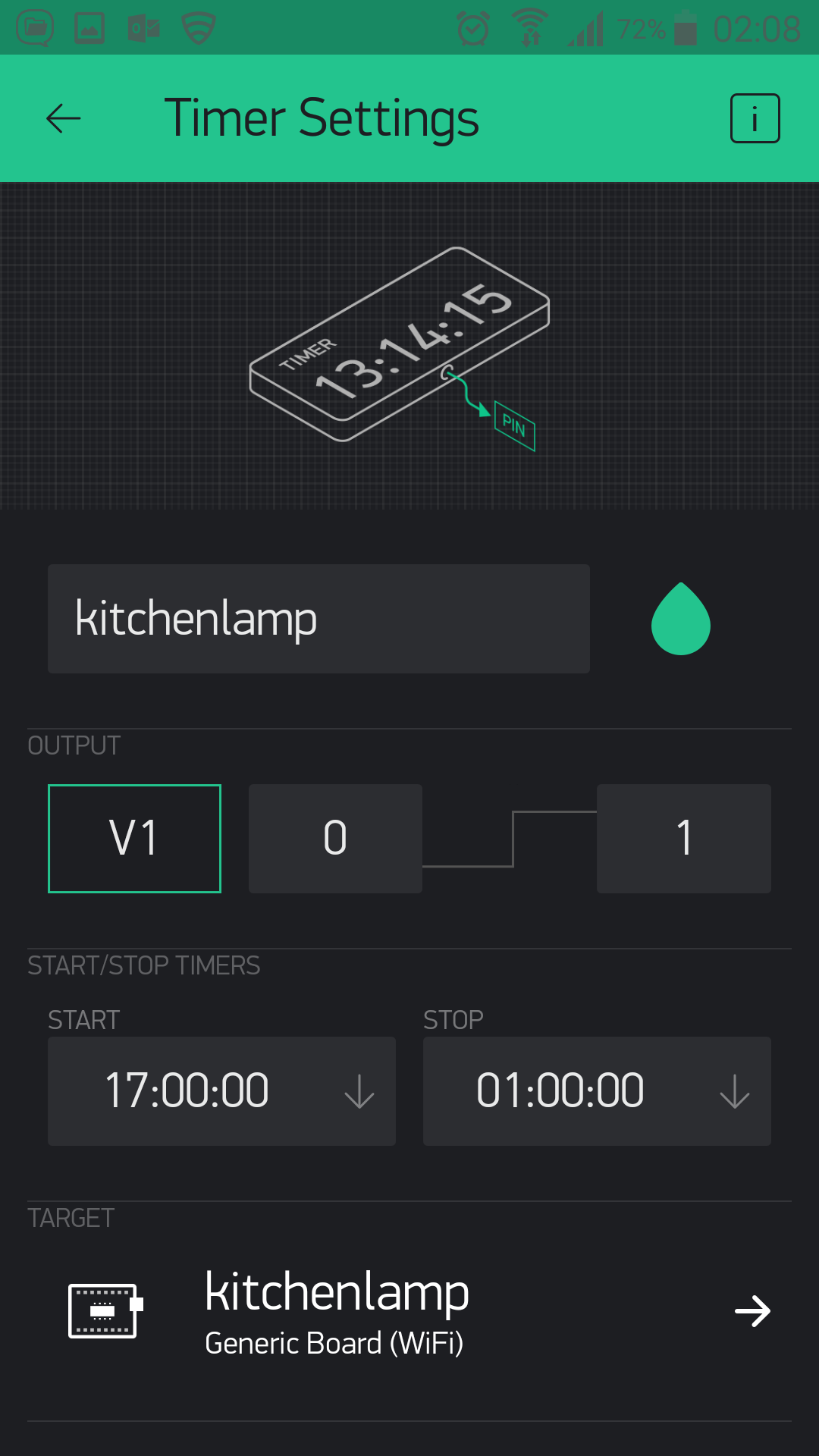

the app side layout 2 buttons with 2 timers
the codes are identical except for the tokens so i’m only showing one code.

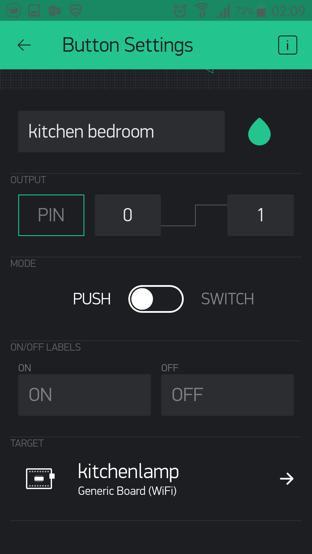

screenshots of app buttons and timers and the button containing the TAG of the 2 devices namely kitchenlamp & bedroomlamp.
the final screenshot is of the BUSY vpins.
i’m guessing that i need to incorporate V3 in my code to use in the TAG button?

that is what i have done

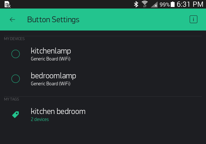

Based on your QR… when in the edit of the Kitchen Bedroom Button, click on Target and select the option under My Tags.
Then when pressing that button, it should activate same vpPins on both devices
what pin goes in the pin field
Same pin as the other two devices… edit… oh I see… busy… hold on please, your call is important to us… :wink:
OK, in all three buttons you need to select the tag as the target… try that first, then you can select V0 in the third combo button, then go back and sort out the tags?? Kitchen to Kitchen device, Bedroom to Bedroom device, combo to both tagged devices
solved it’s the GPIO D2 pin that needs selecting instead of the V pins which show as busy, the only drawback so far is that it doesn’t sync with the VO button and light it up when the TAG button is ON and lit up.
