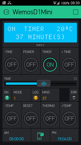

@Dave1829 I have a similar project to you and up until a few days ago two or three buttons linked to virtual pins were handled in the following way:
BLYNK_WRITE(V0)   // manual control
  int ManualMode = param.asInt();
  if (ManualMode == 1) {
     Blynk.virtualWrite(V1, 0);  // timer control button off
     Blynk.virtualWrite(V2, 0);  // thermostatic control button off
     ManualFunction();
BLYNK_WRITE(V1)   // timer control
  int TimerMode = param.asInt();
  if (TimerMode == 1) {
     Blynk.virtualWrite(V0, 0);  // manual control button off
     TimerFunction();
BLYNK_WRITE(V2)   // thermostatic control
  int ThermoMode = param.asInt();
  if (ThermoMode == 1) {
     ThermoFunction();
So as you press one button it turns off the other buttons in the app and it works fine. Also up until yesterday I had my system start up in a known state of off but decided I wanted to use syncAll instead.

Our system is ‘the same’ as Google’s Nest and British Gas’ Hive but without their multi million (billion) dollar budget :grinning:
Central heating control via the internet (Blynk) using off the shelf RF controlled boiler switches. Our Wemos with DS18B20 and RF transmitter send the required RF signals for on and off based on room temperature, time of the day or specified amount of time etc.

Firmware updates to the Central Heating (ch) system are available by pressing a Blynk button, opening a web browser at http://ch.local/update and flashng the latest bin via OTA. Currently the system requires users to receive the bin file by email but we have started coding automatic firmware updates which will be sent from one of our servers. OTA seems a bit flakey on our Ubuntu test system but flies with Windows (much faster and more convenient than a USB cable). Anyone else using OTA with Ubuntu (14.04)?
Need to see if we can get Serial Monitor equivalent with OTA for debugging purposes.
All integrated with @tzapulica’s WiFiManager so we can access any router with any Blynk token without changing the sketch. WiFiManager moved on to version 10 a few hours ago and it just gets better and better.
