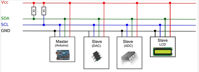

Your wiring using I2C bus should be like this example:
1 Master (Esp8266) and several Slaves (BMP180 and BH1750) together with Pull-up resistors in your case.

Thanks. That was my mistakes:-)

the whole point of using I2C sensors is that they can wall exist on the same pins, which is why i said:
when you asked:

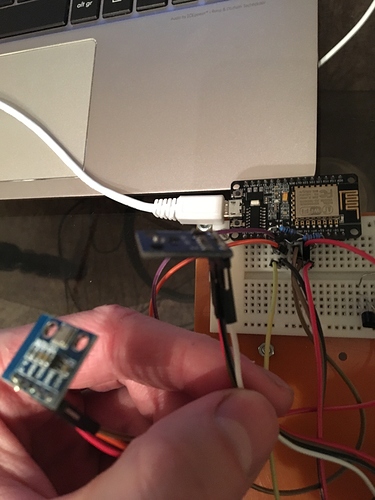

So yes. That was mistake.I now use rezistors for pins D6 and D7. And BMP and BH are working togetherā¦
Thank you.
