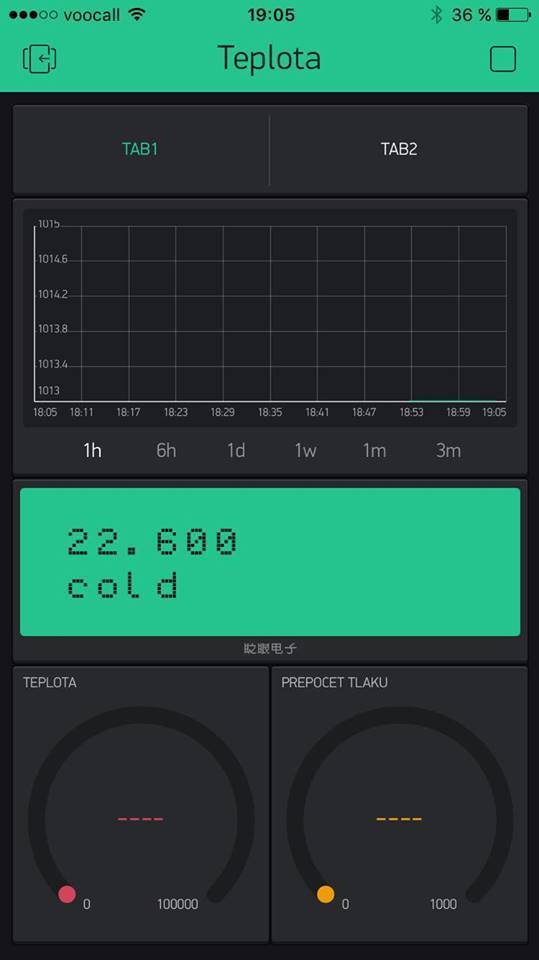

Yes.Ok. But I dont know good position for lcd.clear… This position no good working:
Blynk.virtualWrite(12, bt); // virtual pin
lcd.print(1, 0, bt);
if (bt > 29) {
lcd.clear();
lcd.print(1, 1, "hot");
if (bt < 29) {
lcd.clear();
lcd.print(1, 1, "cold");

Yes with out lcd.clear is it showing bt.:
lcd.print(1, 0, bt)
if (bt >= 29) {
if (bt <= 29) {

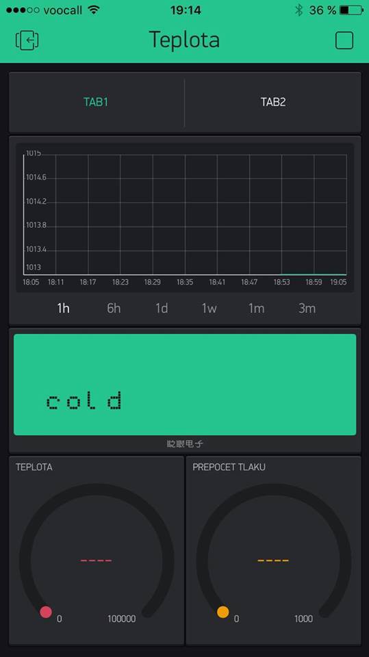

And with lcd.clear no
if (bt > 29) {
lcd.clear();
if (bt < 29) {
lcd.clear();
put it before
and it will work
…or just add one sign to "hot "
Then in this case You don’t need lcd.clear()
Yes it it one choice. Thanks.
