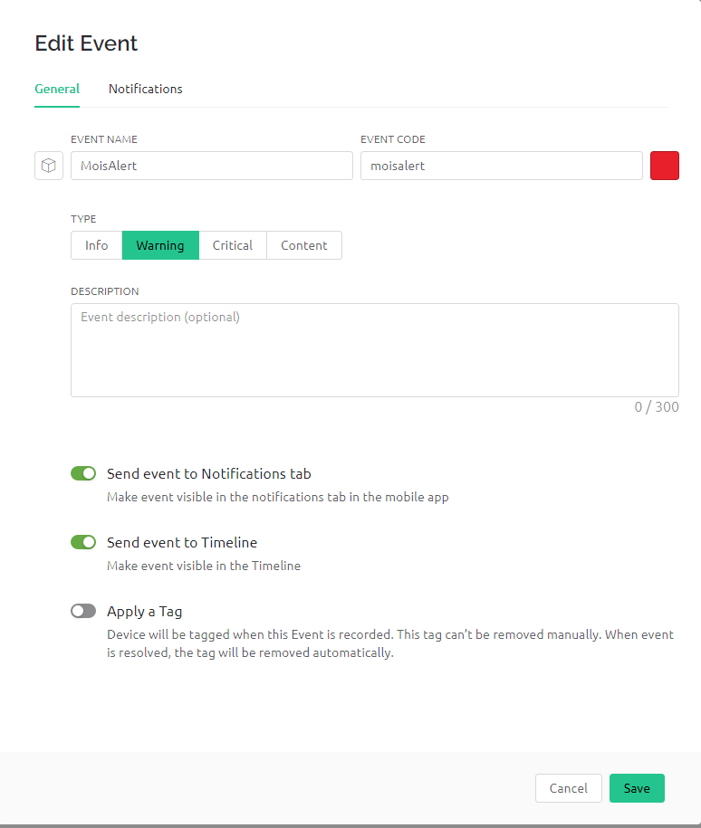

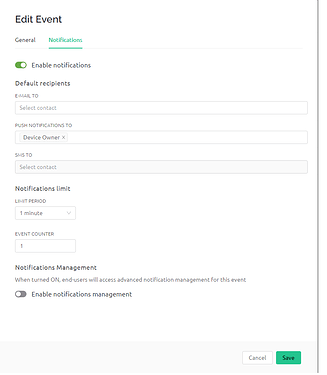

I want to make notification delay every 1 minute
This is my event setting:

The simple solution is to call sendSensor once every minute, rather than every second.
In this scenario that doesn’t seem like an unreasonable thing to do.
Alternatively, put your humidity alert in a separate function and call that every minute.
Pete
Do you have any example code.
I have no idea about this code.
Use 60000L instead of 1000L, so it will be like this
timer.setInterval(60000L, sendSensor);
