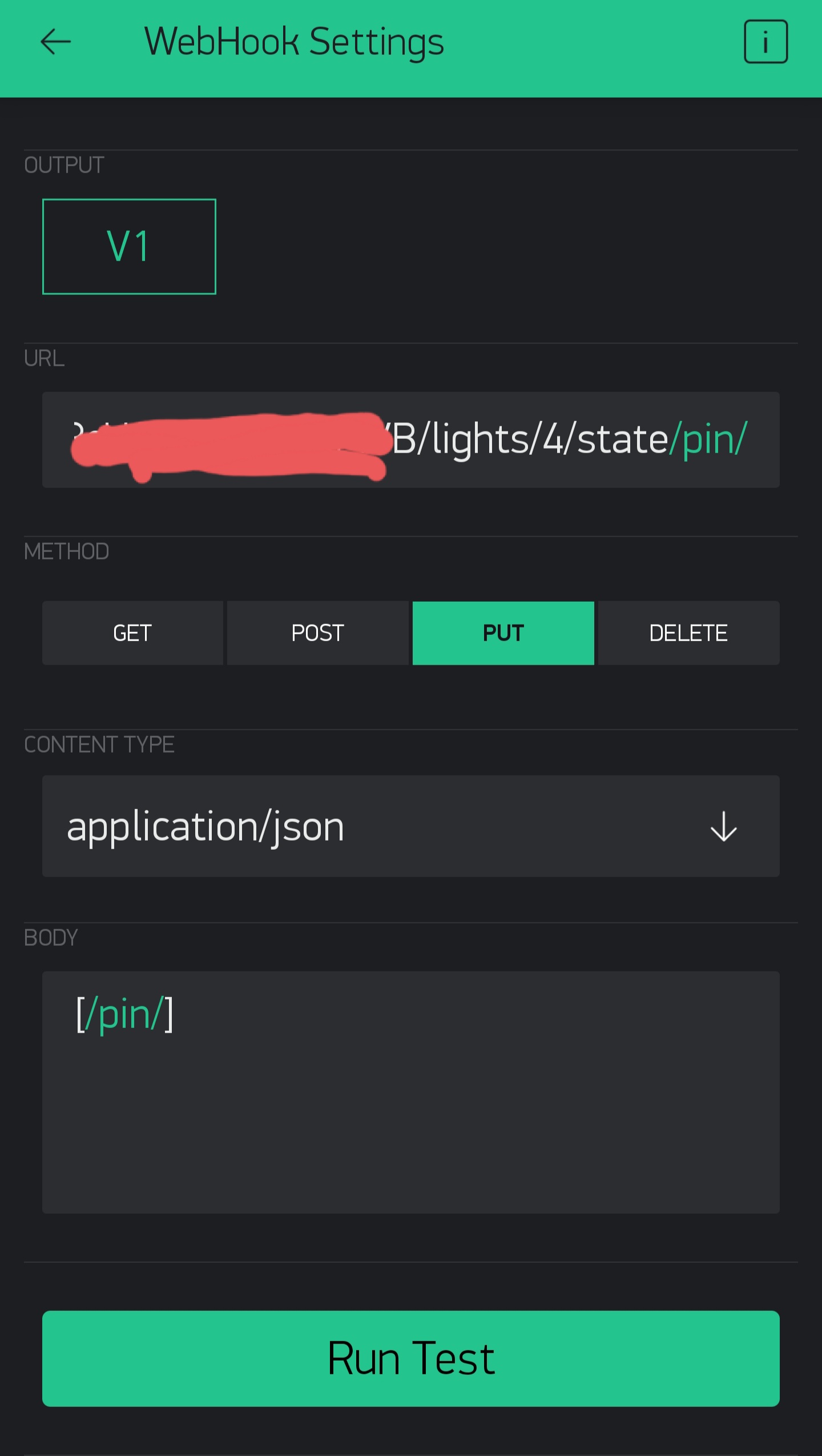

I want to create buttons for on and off of my home lights via Phillips Hue platform. I create with success the interconnectio via webhook in my blynk app and when I run the test work perfect. I want now to create the button and I don’t find how I can trig wehook function. Can someone help me?

This is my code :
String lighton = "true";
String lightoff = "false";
if(light_state == 1)
   led1.on();
  String msgBody = ("{""\"on\":" + String(lighton)+ "}");
  Serial.println(msgBody);
  Blynk.virtualWrite(V1, msgBody);
      led1.off();
      String msgBody = ("{""\"on\":" + String(lightoff)+ "}");
The serial answer is correct. {“on”: false} or {“on”: true}
My blynk webhook is the follow :
But i can’t control the light.
Any suggestions?

Final my solution for the Philips Hue interconnection :
HTTPClient http;
String req_string;
req_string = “http://”;
req_string += “192.168.1.40”; //Philips Hue router IP
req_string += “/api/”;
req_string += “HhaR8veR-Odqa7n2aYRWZuEmT8cHGxxxxxxxxxx”; //Philips Hue ID
req_string += “/lights/”;
req_string += 4; //light ID
req_string += “/state”;
Serial.println(req_string);
http.begin(req_string);
http.addHeader(“Content-Type”, “text/plain”);
String put_string;
put_string = “{“on”:”;
put_string += “true”; //true = on, false = off
put_string += “}”;
int httpResponseCode = http.PUT(put_string);
if anyone need any help for Philips Hue i am here for support.
