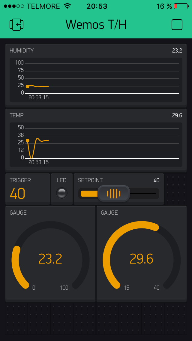

Hi, I’m trying to merge code for temperature and humidity based on DHT22 readings with Arduino PID control.
I’m unsure how to get get the correct output.
I would like to be able to set the setpoint humidity by the blynk slider ex. at 40% and also follow the flow and the measurements as the screen dump below.
Ok first of all if you don’t know theory behind PID please read it as it helps a lot in understanding what you are doing, why and how you gonna achieve it. Based on what you chose your P, I, D? Have you done any tuning of your system whatsoever? Make sure you are casting your variable correctly from float to double when initializing myPID. Also you need to set sampleTime for myPID

Start tuning from having I and D as 0 and changing P only then adding other parameters. Plot your graphs using Plotly for example as with Blynk it’s gonna be quite hard. Write some code to be able to change PIDs on the fly through serial port or in Blynk. Lastly add some filtering to your humidity readings cause you don’t want some disturbance to alter your system (as I can see it fluctuates a lot on your graph)

The reason for your code not to work is fact that your PID is broken as Input you should use humidity readings. Your set point should be some constant or variable you want to have and the output is pretty much relay state. In your code nothing changes.
There is however one big “but”. Why you are using PID if you only control 0/1 state of your humidifier. In my opinion using PID in your case doesn’t make sense because the whole point of PID would be to control intensity or the power output of your humidifier. Read about PID and think about it
