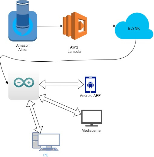

But in my case, I am receiving a pin value though the Blynk API, and I want to transfer that value to another device using the GET request (or actually I would rather connect straight to a HOST + PORT, but I have been unable to find a way to do that without disconnecting from the blynk cloud (by using ESP8266 libraries instead of the Blynk ones)).
so I am not using the app or the widgets at all in this case.
an alternative is to query the API through the other device, but that would mean to query it on a timer, and also I specifically want the arduino to send the data
This is what im trying to achieve, everything is almost done except for this last part
What format is the pin value you are receiving?
Also is the “Android App” shown in your image the Blynk App or one you knocked up?
its an integer which has a corresponding ID in one of the targeted devices.
I made my own windows app and an android app, which among other things, open a server and listen for incoming data.

It would not work according to the diagram I made above.
The Blynk API call is being made via AWS Lambda (according to my voice command using an Echo dot), the value is then received in the Arduino which is connected to Blynk, from there the Arduino needs to automatically forward the value (without manually pressing any buttons) to the correct device on the network based on the value it received from AWS.
