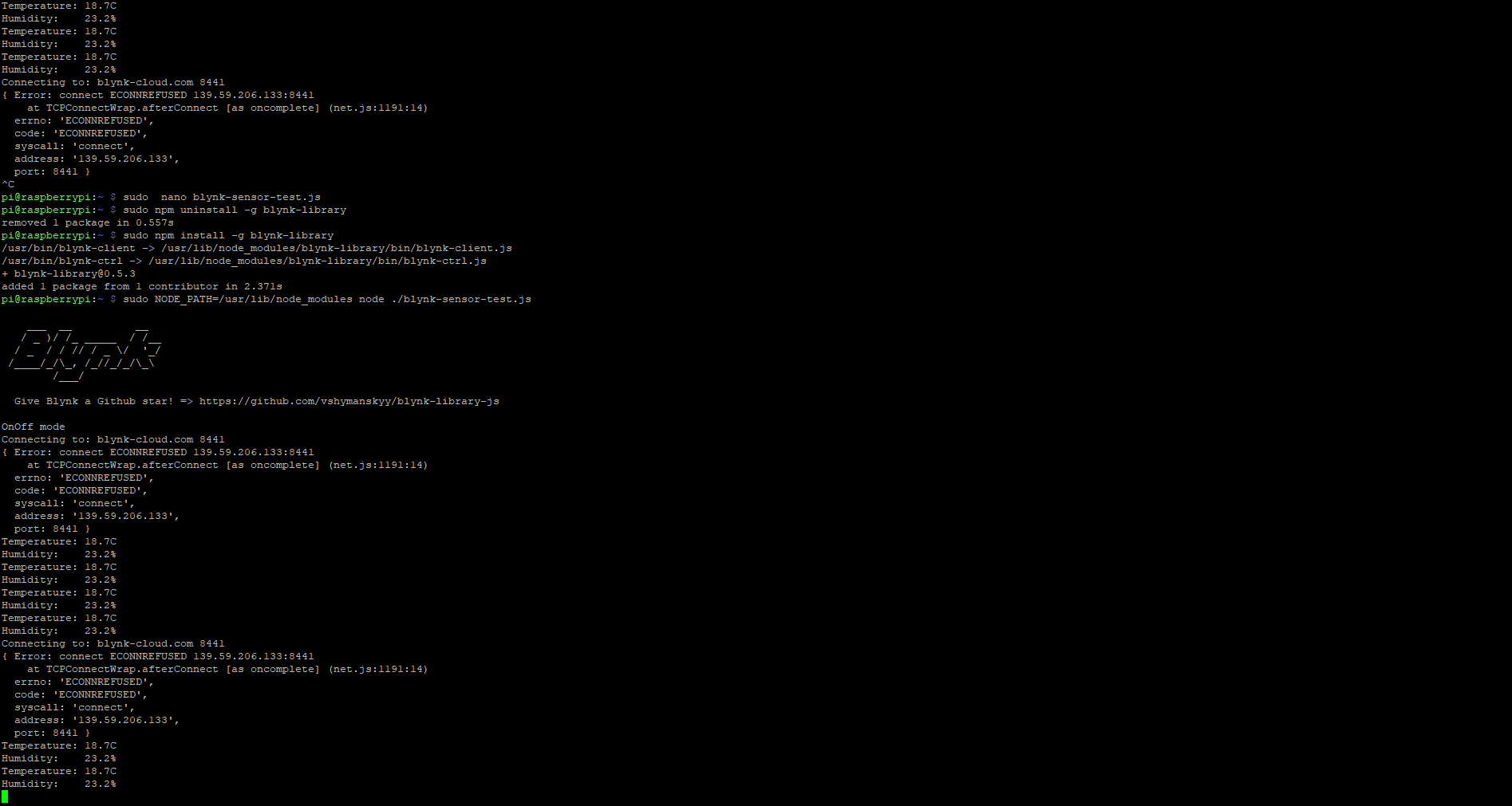

and afer i find the port 80 into the files but when i call the client again:
Give Blynk a Github star! => GitHub - vshymanskyy/blynk-library-js: Blynk library for JS. Works with Browsers, Node.js, Espruino.
OnOff mode
Connecting to: blynk-cloud.com 8441
{ Error: connect ECONNREFUSED 139.59.206.133:8441
at Object.exports._errnoException (util.js:1020:11)
at exports._exceptionWithHostPort (util.js:1043:20)
at TCPConnectWrap.afterConnect [as oncomplete] (net.js:1099:14)
code: ‘ECONNREFUSED’,
errno: ‘ECONNREFUSED’,
syscall: ‘connect’,
address: ‘139.59.206.133’,
port: 8441 }
if have no idea where comes the 8441 from?

Gunner, no its run in that folder and u can see it at the snap before as well but here is the snap from the blynk-node.js too:
shows port 80 too
@Guido_Solar post the command that you are calling to run the client script.
@Viperuss I can see your script is: blynk-sensor-test.js
Can you post the first dozen lines from this file.
