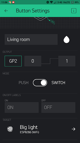

What are the min/max setting in your button widget?
@BlynkAndroidDev
It simply goes from 0 to 1.

Edit: I discovered a work around by deleting the device in Blynk and then adding a new one with the same function. So it does seem there is a problem in the app instead of my hardware. @BlynkAndroidDev
Could you describe more this workaround with device deletion? Also could you attach here screenshot of button’s settings page?
I simply deleted the button and then the device in Blynk. I then added a new device with the same name but obviously a different auth token. Uploaded the new token to my esp8266 and added a new button with the new device in Blynk.
