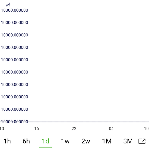

Hi @BlynkAndroidDev, I’d like to advise about a possible bug in superchart. It doesn’t seem to like to chart negative values. eg. in chart setting I set min/Max setting from -10000 to 10000. Blynk legacy was perfect but Blynk 2.0 does not chart :frowning_face:

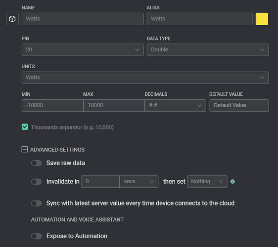

How is the datastream configured in the web dashboard?
Hi Pete, Thank you for your interest…This is my data stream configuration. I’ve tried a few variations in the settings. (Integer, without units). It graphs correctly if I have a positive value in the ‘min’ field within the app settings that.s why i’m thinking its a bug.

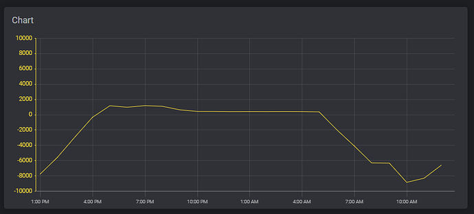

Web dashboard graph charts correctly however it does lack detail for the ‘1 day’ graphing selection…

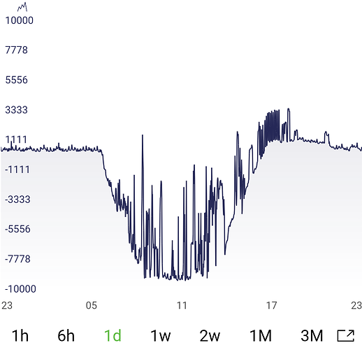

@GG07 Thanks for the report, I will soon upload a fix to Play Store. This bug happens only for datastreams with minimum value -1k and less (-10k, -100k).
New build will have the same version (1.3.2), I hope it will be available in 4-6 hours.
Can confirm that this issue has now been fixed by @BlynkAndroidDev very quickly… Thank you.
