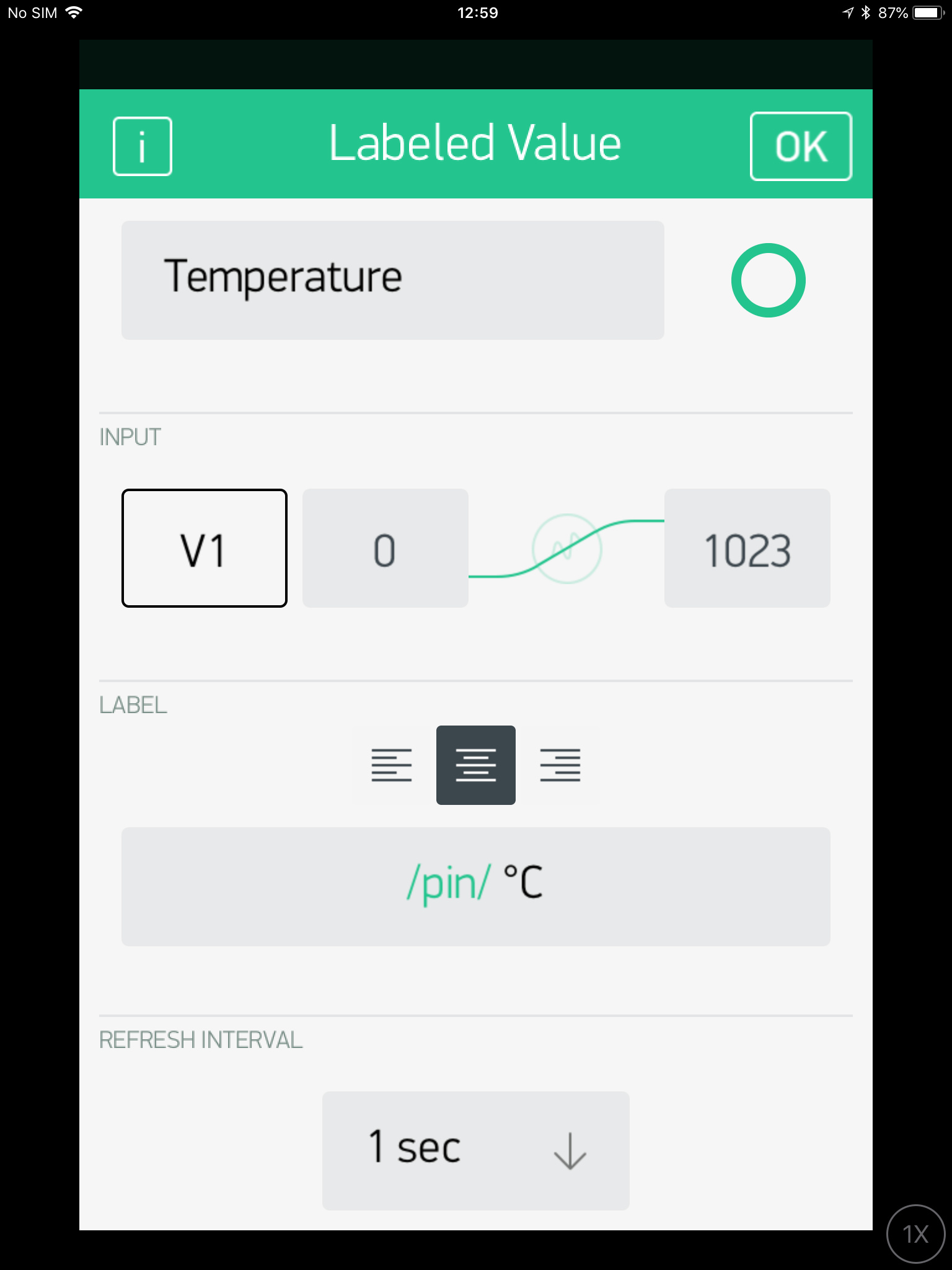

Newbie question on Blynk.virtualWrite(…)
on many screenshots I’ve seen a decimal value followed by an unit string such as
25.4 °C
In plain C I would use printf(…). How can I do it with Blynk.virtualWrite(V4, outdoorT) ?

You’d normally do it in the widget setup, rather than in code:
The degrees symbol is generated with a long press on the zero key of your mobile device.
